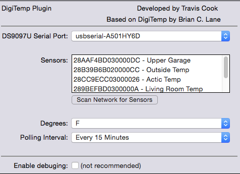

Well i installed the modified plugin which brought me up to v1.0.4 I think it got worse. Still is random of what i get when i scan for sensors, as you see in the errors. the first 10 lines was repeated 4 or 5 times over in the log. It seemed to have a hard time finding the adaptor. As before what ever sensor wasn't found wont show up on Indigo. But when i did get all 6 sensor in the scan in this case the upper garage temp didnt show up on Indigo even though it was found in the scan, after a few tries the config screen shot looked normal. What i will can try next is what your previous sugestion was and try running DigiTemp directly and by pass Indigo and the plugin and see what that turns out.
Bret
DigiTemp Error DigiTemp Error:
Error 5: DS2480B Adapter Not Detected
Error 10: Read COM Failed
DigiTemp Scan complete, found 0 sensors.
Interface Failure lost connection with interface
Connected to PowerLinc 2413U interface on port usbserial-A700ahWO
PowerLinc address 18.B7.20, firmware version 9.2
Jan 5, 2017, 8:07:26 PM
DigiTemp Starting scan for 1-wire sensors.
DigiTemp Found sensor ID: 28CC9ECC03000026
DigiTemp Found sensor ID: 28AAF4BD030000DC
DigiTemp Found sensor ID: 28F607CD030000CF
DigiTemp Scan complete, found 3 sensors.
Jan 5, 2017, 8:07:57 PM
DigiTemp Found sensor ID: 28DE3ECC03000020
DigiTemp Found sensor ID: 28B39B6B020000CC
DigiTemp Found sensor ID: 289BEFBD0300000A
DigiTemp Scan complete, found 6 sensors.
DigiTemp DigiTemp initialized to read 6 sensors every 15 minute(s).
Jan 5, 2017, 8:08:53 PM
DigiTemp Error DigiTemp process exceeded our time limit so it was killed.
Jan 5, 2017, 8:09:31 PM
Jan 5, 2017, 8:10:00 PM
Schedule Poll Twilio For Message
Jan 5, 2017, 8:10:24 PM
Jan 5, 2017, 8:11:00 PM
Jan 5, 2017, 8:20:00 PM
Jan 5, 2017, 8:25:21 PM
Received INSTEON "Hallway Motion" on
Jan 5, 2017, 8:25:52 PM
Received INSTEON "Hallway Motion" off
DigiTemp Error "Upper Garage" sensor was not updated at the poll interval.
Screen Shot 2017-01-05 at 8.50.45 PM.png (57.64 KiB) Viewed 6902 times
