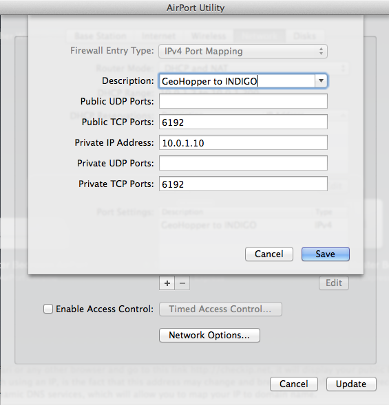

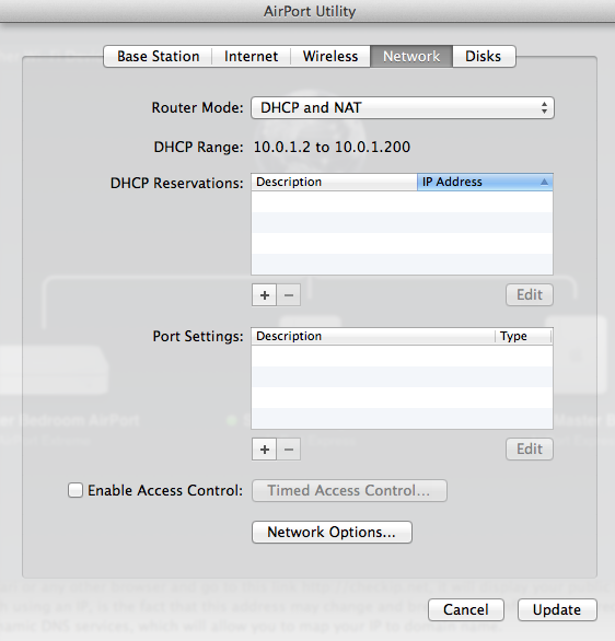

I have the iPhone app setup ok I believe. I got the IP address of the router from Airport Utility, added the web service using http://(Router IP address):6192.
Let me see if I can give you a hand. First off, when you say the router IP address, are you referring to the internal private IP address of the router, it sure sounds like it? A router has at least two IP's and you will need to use the public dynamic or if you do have a static IP that you received from your ISP. Open Safari or any other browser and go to this link http://checkip.net, it will display your public IP, which is what is needed. The only problem with using an IP, is the fact that this address may change over time and break your configuration. I recommend you sign up for one of those free Dynamic DNS services, which will allow you to map your IP to domain name.
To configure port forwarding launch Airport Utility, found in your Utilities folder and go to the Network tab and locate the Port Setting sections and click on the + plus sign. Fill in the Public TCP port 6192 and the same port number for the Private TCP port. No need to bother with filling in UDP fields, leave them blank. Under Private IP address enter the IP of your INDIGO Server.
I hope this helps?

Helpful for sure. I was using the IP you get when you click on the picture of the internet in Airport Utility..... And I didn't have the Server IP in the Private IP field.

When I first setup the port forwarding it defaulted the Private IP address of 10.0.1.201... I found the computer IP address in Network Preferences and edited the IP field, saved and ran a Test from the geohopper iPhone app.
