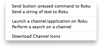

Hi Dave - if I understand correctly, what you want to do is not add a Device State, but add a new Roku Network Remote Plugin Action.
First, add a new Static Image, and then select "Server Action" at the bottom of the CP editor window. Then, look for Roku Network Remote Plugin Action and you will see the following options:
Screen Shot 2015-11-25 at 6.37.47 AM.png (24.06 KiB) Viewed 6355 times
Dave

Thanks, that worked :D ...ish...so how do I get the CP to Control the other areas, launch an app etc, download channel icons? I tried the same process but nothing happens :( .......so with your help I have navigation controls...its a good start
Cheers
Dave
