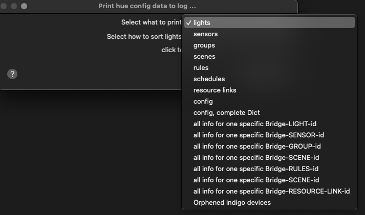

Re: Hue Lights discussion
1.9.14 @ 2022-03-16
* did a lot of testing
* fixed several bugs ie when more than one bridge is used
* added several print options (for rules, schedules, resource links, config, user lists (whitelist) etc)
* added print option for orphanes, indigo devices that do not exists anymore on the bridge
* tested with 3 bridges, 70+ lights, 30+ sensors/ switches
https://github.com/IndigoDomotics/Hue-L ... ag/v1.9.14
print menu: orphaned indigo dev report looks like ( added a 3.rd bridge and deleted devices on bridge 1&2 and recreated them on the 3rd bridge):

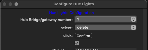

Decided to install 1.9.14 and get the following
So I went back to 1.7.65 and all is working fine again
Any ideas?
16 Mar 2022 at 19:46:51
Hubitat Bridge received "HE 1 Ch Zigbee No Neutral Switch" voltage "247 Volts" event
Stopping plugin Hue Lights (pid 733)
Stopped plugin Hue Lights
Upgrading plugin Hue Lights to newer version 1.9.14 (previous version moved to trash)
Loading plugin "Hue Lights 1.9.14"
Starting plugin "Hue Lights 1.9.14" (pid 50992)
Hue Lights Starting plugin initialization.
Hue Lights initializing ...
Hue Lights path To files: =================
Hue Lights indigo /Library/Application Support/Perceptive Automation/
Hue Lights installFolder /Library/Application Support/Perceptive Automation/Indigo 2021.2/
Hue Lights plugin.py /Library/Application Support/Perceptive Automation/Indigo 2021.2/Plugins/Hue Lights.indigoPlugin/Contents/Server Plugin/
Hue Lights Plugin params /Library/Application Support/Perceptive Automation/Indigo 2021.2/Preferences/Plugins/com.nathansheldon.indigoplugin.HueLights/
Hue Lights logger enabled for INFO ==> TEST ONLY
Hue Lights Warning logger enabled for WARNING ==> TEST ONLY
Hue Lights Error logger enabled for ERROR ==> TEST ONLY
Hue Lights Error logger enabled for CRITICAL ==> TEST ONLY
Hue Lights check /Library/Application Support/Perceptive Automation/Indigo 2021.2/Logs/com.nathansheldon.indigoplugin.HueLights/plugin.log <<<< for detailed logging
Hue Lights Plugin short Name Hue Lights
Hue Lights my PID 50992
Hue Lights set params for indigo V 2021.2
Started plugin "Hue Lights 1.9.14"
Hue Lights debug areas:[]
Hue Lights hostIds read: {u'1': u'', u'0': u'QqOYkfQWel5fIDNv2ETBzZex43Itz5-I4utYEv-b'}
Hue Lights ipAddresses loaded:{u'1': u'', '0': u'192.168.100.240'}
Hue Lights Error Failed to connect to the Hue bridge at . - Check that the bridge is connected and turned on.
Hue Lights brdiges paired read: {'0': False}
Hue Lights bridge: 0 loaded: light(s): 0; group(s): 0; scene(s): 0; user(s): 0; resource(s): 0; rule(s): 0; schedule(s): 0; sensor(s): 0
Hue Lights Unexpected response from Hue bridge () when loading available sensors!
Hue Lights -2 fewer Hue sensors were found on the Hue bridge. Check your Hue Lights Indigo devices. Some of them may have been controlling the missing Hue sensors.
Hue Lights Error Unable to obtain list of Hue lights from the bridge. at line:5824; error msg:global name 'lightsListResponseData' is not defined
lastCount:{u'1': 0}
Hue Lights -15 Hue light removals were detected on the Hue bridge. Check your Hue Lights Indigo devices. Some of them may have been controlling the missing Hue lights.
Hue Lights Error Unable to obtain list of Hue groups from the bridge. at line:5938; error msgglobal name 'groupsListResponseData' is not defined
lastCount:{u'1': 0}
lastCount:{u'1': 0}
16 Mar 2022 at 19:54:06
Stopping plugin Hue Lights (pid 51323)
Downgrading plugin Hue Lights to older version 1.7.65 (previous version moved to trash)
Loading plugin "Hue Lights 1.7.65"
Starting plugin "Hue Lights 1.7.65" (pid 51387)
Started plugin "Hue Lights 1.7.65"
Hue Lights Loaded 15 lights.
Hue Lights Loaded 17 groups.
Hue Lights Loaded 51 scenes.
Hue Lights Loaded 2 sensors.
16 Mar 2022 at 19:56:11
Sent Hue Lights "Conservatory Light" on to 100 at ramp rate 2.0 sec.
Sent Hue Lights "Conservatory Light" off at ramp rate 2.0 sec.
Sent Hue Lights "Back Door Light" off at ramp rate 0.0 sec.
CliveS
bridge(hostId) #1 is enabled and has no ip number assigned.
go into config, select bridge #1 and delete it
and click confirm
ps and the little checkbox should not be visible , should be hidden, ignore itI forgot the hidden=true
it is used to show the rest on the config or not, has no impact on the function
hidden="true"it is used to show the rest on the config or not, has no impact on the function

Let me know if you need more information
I have been getting the following eror like mentioned previously:
Hue Lights Error Error in plugin execution ExecuteAction:
File "plugin.py", line 11526, in recallScene
File "plugin.py", line 9482, in doScene
KeyError: (False,)
Reading the previous threads I am not able to solve it the same way.
Editing the actions and selecting the hue bridge number, I am not able to select 0.
Option is: Failed to get UI list from Plugin.
Invalidparametererror> plugin does not define methord gwl.istgenerator
Reloading, etc. does not bring anything nor does restarting the Hue Bridge.
Below some information that might help.
I am pretty lost right now. Hope you can help. Thank you...
