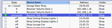

I seem to have lost control of my receiver. It shows as online in my router config and
the IP hasn't changed. Also shows as connected in the device list but it won't respond
to any commands or update it's status.
Running v1.04 and 10.8
Any idea what may be happening?
Carl

@Carl: If your VSX-1122 is connected via Ethernet, unplug the Ethernet cable for a few seconds then plug it back in. If using wireless, turn off wireless in your VSX then back on. That'll reset any TCP connections. Also try reloading the plugin.

  Pioneer Receiver Debug          sendCommand: Telling Lounge - AV Receiver: ?RGB33
  Pioneer Receiver Debug          connect: Connection wait count: 0
  Pioneer Receiver Debug          readData: Lounge - AV Receiver said: RGB021Radio
RGB030CD-R/TAPE
RGB010CD
RGB041Wii
RGB050TV
RGB251PS3
E06
E06
RGB100VIDEO
RGB151Front Door
E06
RGB170iPod/USB
RGB190HDMI 1
RGB330ADAPTER PORT
  Pioneer Receiver Debug          processResponse: from Lounge - AV Receiver.
  Pioneer Receiver Error          Lounge - AV Receiver: parameter error.

nsheldon
Posts: 2469
Location: CA
Re: Pioneer Receiver discussion
Post by nsheldon »
Hi durosity.
Are you referring to the "parameter error?" The receiver is returning that error (you can see the "E06" in the raw output) because the Pioneer Receiver plugin thinks the 922 is a 1122 and is asking the 922 to give it the names of inputs the 922 doesn't have (but the 1122 does). I'll look into adding the VSX-922 to the compatibility list, though it could take a little time as it's fairly involved (every new receiver added to the plugin has it's own group of feature and input compatibilities that the plugin has to check each time it sends a command or receives a response, so there's a lot of code to copy and paste then edit for each additional receiver supported). In the meantime, you might try using the VSX-1021-K plugin model instead to see if that reduces the errors.
Regards,
Nathan
durosity
Posts: 4810
Post by durosity »
Indeedy, I'm just surprised it's not as its worked perfectly fine on the 1122 setting for 18 months (the 922 is near identical to the 1122 sans a couple of minor features.. Even the manuals are shared)

(Also FYI the 1021 setting doesn't help.. In the mean time I've reverted back to the 1.04 version which works perfectly)

Version 1.0.6 Released
  • Fixed bug in 1.0.5 that caused every receiver except for the VSX-1021-K to return E06 (invalid parameter) errors when the Pioneer Receiver plugin attempted to gather all input source names.
nsheldon
Posts: 2469
Location: CA
Post by nsheldon »
durosity wrote:(Also FYI the 1021 setting doesn't help.. In the mean time I've reverted back to the 1.04 version which works perfectly)
Give the 1.0.6 version a try @durosity. The errors in 1.0.5 were my fault. I left out necessary code that was in 1.0.4 which checked valid source inputs against the receiver model info in the plugin. I've put that code back into 1.0.6.
