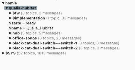

Some assistance for a newbie to Hubitat Bridge plugin, please.
I have successfully got Hubitat communicating with my MQTT broker (running Mosquito on dedicated raspberry pi) that I am also using successfully with the MQTT Shims plugin.
My issue is getting the bridge to remain connected to the broker in Indigo . Despite searching on this forum and the internet generally for a solution I am getting continuous logs in Indigo of:
My suspicion is that my issue lies with the plugin configuration, and particularly the MQTT Client Prefix entry. I have tried all sorts of combinations without success! The relevant section of the data from MQTT Explorer is shown in the attached screenshot. Would someone clarify exactly what the prefix I should be using?
Some examples from working installs might help!
If this is not the issue, can someone suggest where I should be looking!!??
Thanks in advance
Hubitat Bridge 'Qualia Hubitat Bridge' reconnected to MQTT Broker.
Hubitat Bridge Warning 'Qualia Hubitat Bridge' encountered an unexpected disconnection from MQTT Broker [Code 5]. Retrying connection ...Some examples from working installs might help!
Thanks in advance
mclass
- Screen Shot 2022-01-27 at 6.13.59 pm.png (30.56 KiB) Viewed 3916 times

Is your MQTT Broker password protected? The plugin doesn't currently support that.mclass wrote:Some assistance for a newbie to Hubitat Bridge plugin, please. ...
If you can confirm or otherwise I will take a look at that.

Got it one, thanks!! Now to sort out that prefix setting….

It can be anything e.g. mac_mini or imac_one etc.mclass wrote:Now to sort out that prefix setting….
It's just a prefix for a unique id the plugin generates to use when connecting to the MQTT Broker.
