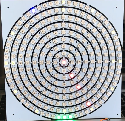

the neopixel clock now has many more options for hour/min/secs with:
- 1-3 LED on,
- show pixels in various rings,
- blink pixels from on/off to 59 secs on/ 1 sec off (e.g. off when minute changes .. off every 10 sec 15 secs 30 secs ..)
really cool now
a pic of the neo pixel clock. the colors and intensities are not well reflected in the iPhone image , they are too bright .
will add more details in the neopixel section (the neopixel device shown is ~ $51.)
- 1-3 LED on,
really cool now

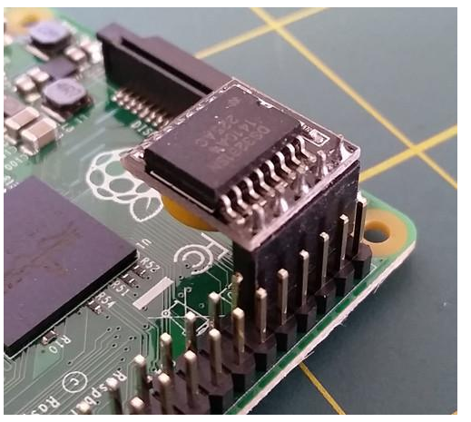

support for hardware clock (RTC) model DS3231 and DS1307(should work, not tested)
You need to add the HW clock selection in RPI device edit. The rest is done by the plugin.
It adds to /boot/config.txt.: and to /etc/rc.local See
https://trick77.com/adding-ds3231-real- ... erry-pi-3/ and many other pages for discussion on this topic.
if you add/ remove the clock the plugin will add/ remove the changes from the system files and reboot.
These modules are very cheap ~ $1.50 with shipping and battery from china - via eBay.
The module goes on the GPIO header in the i2c pin section: 1,3,5,7,9 (needs V3.3, i2c and ground)
Please be aware that these clocks use 0x68 as their i2c address. If you have a sensor that uses the same.. no luck.
In addition the plugin will update the date/time on the RPIs automatically if they are off by > 10 secs. You can do this also in the menu or in an action. The resulting time delta is better than 0.5 secs.
dtoverlay=i2c-rtc,ds3231Code: Select all
/sbin/hwclock -shttps://trick77.com/adding-ds3231-real- ... erry-pi-3/ and many other pages for discussion on this topic.

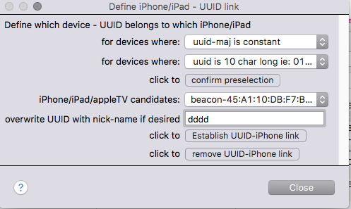

posted v 7-64-140
added:
for apple devices that change MAC numbers but keep part of the UUID-MAJ-MIN message fixed:
you now can link
UUID or
UUID-MAJ or
UUID-MAJ-MIN or
UUID--MIN
to a fixed MAC number
When ever a uuid-xx message gets received, the RPI will overwrite the received MAC number with the MAC number in INDIGO. If it has changed or not.
Use the menu item "Define iPhone/iPad - UUID link" to set it up. You can also setup a name that will overwrite the UUID part in the notes field.
Not completely tested, but it seems to work. I still need to make the menu a little bit more elegant.. currently it forgets previous settings etc ..
added:
you now can link
UUID or
UUID-MAJ or
UUID-MAJ-MIN or
UUID--MIN
