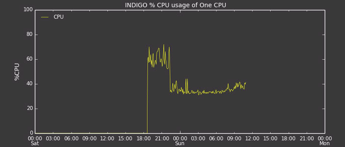

Here a plot of INDIGO CPU usage .. The MAC has 12 cores (2*6) . The total runs at ~ 5%
Started the data collection yesterday evening
using the variable "CPU_usage_AllIndigoAndPlugins" as data source
the drop in CPU at ~ 22:00 is due to stopping the indigo client .. I have a lot of updates
There is also a significant difference what the client window shows:
show all devices no filter : 26%
subfolder with no updates: 19%
window closed : 5%
So if you run a MAC mini with 2 cores, 25% of load of one CPU can be substantial
Screen Shot 2018-08-19 at 11.00.46.png (74.75 KiB) Viewed 8442 times
