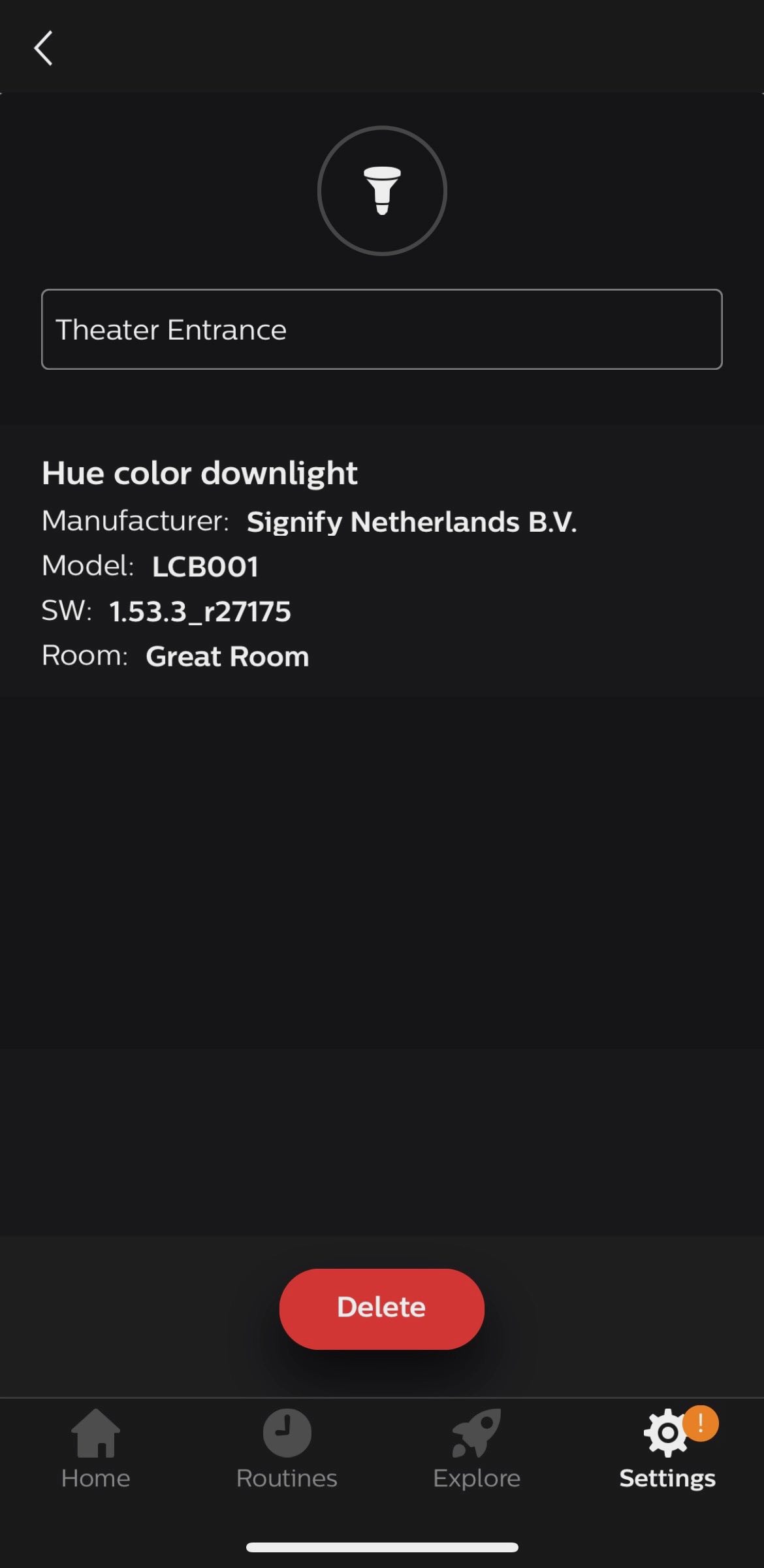

New Hue Spot Lights Not Showing up in Indigo: (White and Color Ambiance BR30)
Greetings, love the plug -in, thank you for such great software.
Just today i installed 13 new Hue spotlights (White and Color Ambiance BR30) , they paired fine with the Hue app, but they don't show up in Hue Plug list in Indigo, all other lights show up, just not the new spotlights. (oddly I can control them via their groups, but they don't pull into the list individually)
On the box is shows model number 9290022175 - is this just a new and unsupported model? Or is there a different location to find these lights in Hue Plug-in.
Other than these 13 new bulbs, everything else shows up as expected, and they are all the same model number.
Thanks in advance, happy to provide any information needed to add them if needed.
-MichaelU

Hi MichaelU.
I'm glad the plugin has been useful. Sorry to hear about the trouble.
Yes, it's probably a new model not yet recognized by the Hue Lights plugin. I can add support in the next patch release of the plugin. The model listed on the package isn't always the model ID reported by the device to the Hue bridge, so I'll need a bit more info from you. Could you either share a screenshot or type out exactly what you see in the Hue app for one of the new BR30 bulbs when you go to the "Settings" section of the Hue app, then "Light setup", then touch one of the new lights to display its detailed info? I need the exact model listed on that screen in order to add support.

Screen shot attached, text as follows:
Hue color downlight
Manufacturer: Signify Netherlands B.V.
Model: LCB001
SW: 1.53.3_r27175
Room: Great Room
I hope that helps, will look fwd to the patch, happy to provide anything else if needed, THANKS AGAIN!
