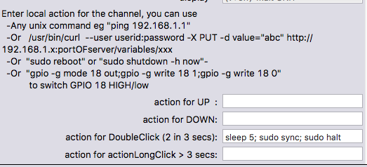

- added local actions to ultrasound distance
These local actions are now available for GPIO input, and distance sensors. They are executed locally on the RPI, hence a VERY fast reaction time to UP/down, close, away, up/down left/right . events is < 0.1 seconds.
example of an action:. That will set GPIO pin 18 up and immediately down again. You would enter THAT text into the action input field in the device edit. Then if the event occurs (close, medium distance, left , up, down ..) that action would be executed locally on the RPI w/o travel to indigo and back to the RPI.
the plugin will install all the required libraries for you.
gpio -g mode 18 out;gpio -g write 18 1;gpio -g write 18 0Karl

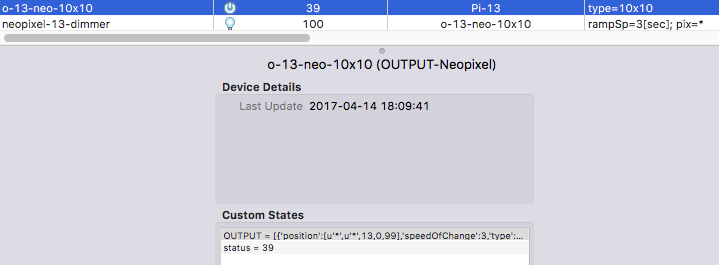

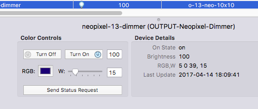

posted V 7-52-78
added:
support for NEO-pixel LED. These are RGB (chains) LEDs you can drive through a single signal wire +ground and +5 V.
10x10 matrix go for ~ $20 from cheap sources. They can light up you room (for 200LED at x20mAmp each gives ~ 4Amps into the LED) That equivalent to >> 100watt incandescent light.
The plugin supports 1, 1x2..1x100 (long strips) or 2x2 .. 16x16 matrixes of LED.
1. setup a new device in pibeacon, model = NEO pixel and select the # of LEDs.
2. attach the NEO pixel to your RPi:
signal goes to GPIO#18
Ground -- ground
V+ -- V+5V
and for most you need a level shifter. Some (pimoroni https://www.adafruit.com/product/2288 deliver them with level shifter build in and their HAT 8x8 has pins 2, 12,9 (not GPIOs) active. All other grounds are not working !!
3. then create an action pibeacon/neopixel or in pibeacon / menu and there you can
- switch on /off (RGB 0...255) single led, lines, set of less or the full matrix.

added:
RGB dimmer for neo pixel devices.
the plugin/ RPI now supports indigo RGB dimmer devices with RGB and white levels that can be set in the indigo UI.
see details on how to use and configure in the net-pixel discussion thread
added:

- Screen Shot 2017-04-14 at 18.11.17.png (35.3 KiB) Viewed 5109 times
- Screen Shot 2017-04-14 at 22.38.28.png (33.26 KiB) Viewed 5109 times

added:
added an option : enable / disable the automatic addition of one wire temp sensor devices on an RPI. Before once you defined a single oneWire device, you could add many extra and the plugin would add them automatically with their internal ID (28-xxxx). As it happened, I had an RPi that went ballistic(*) and created an unstable oneWire environment and somehow added ~ 800 devices within an hour automatically. So with this option you need to enable the automatic addition of oneWire temp sensors . Once disabled it will ignore any additional (or RPI panic situations)
This will likely never ever happen again, but its good to that have that option anyway.

- Added more local actions ( actions that are executed directly on the RPI without going through indigo.
== double click/touch = 2 clicks in 3 seconds
== long click / touch =one click for > 3 seconds
you could set e.g. in a touch sensor device edit:
double click(touch) reboot RPI. then add a touch sensor ($1) and you have a reset or power down button.. double click / touch it and the Rip will shutdown/ reboot as show here Normally you do not have access to plugin properties (device states yes, properties no). Added a plugin call/ action that allows to get and set any property.. instead of e.g. going through device edit and set eg a property "intensity" to 100. Similar you can read any property,
Set any property of any pibeacon device in python scripts or indigo regular actions, this example script is triggered if any change to light sensor intensity and then checks
if the intensity property of the display device is ==100 , if not and the light value > 5000 and it is after 7 am in the morning set display intensity to 100 and sends an update to the device
