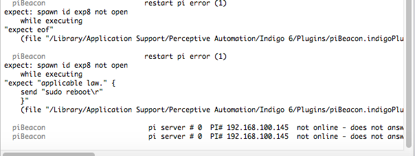

Karl,
I have this error after starting the new plugin (1.5.4) - see attachment.
Something is missing.
yassi
N.B. And in the meantime another error too (the pi is online).Will send you tomorrow an email.
yassi
- Bildschirmfoto 2016-01-28 um 20.01.24.png (38.73 KiB) Viewed 4825 times
- Bildschirmfoto 2016-01-28 um 19.32.57.png (18.16 KiB) Viewed 4877 times
I attached a part of the py-script and as far as I can see it has the modification.
