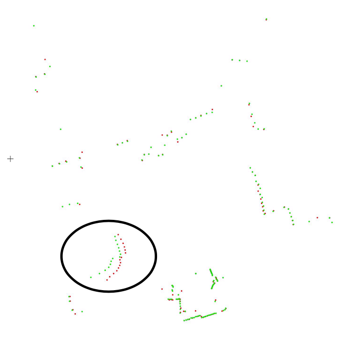

got a RDlidar sensor. Those are laser distance sensors that spin around and give a 2 d view of distance of objects (and walls) to the sensor.
The seems to be promising: it can measure when i walk to or from or sideways of it, sees me waving my hand . .. sees direction
Positioning this in the middle of the room (that will be a problem) would allow a nice view of the complete room = measure any movement .. but limited to one height.
The key measurement is: if for n contigous angles the sum(distance_values) > x or < -x . ==> then there is movement
This can be done for current value vs last value or current value vs empty room value. Thats shows permanent changes, not movement
These are better than the PIR / ultrasound / microwave sensor as they show more details and direction.
will try to add this to piBeacon.
Goal is to combine several sensor type to determine presence
anyway... wanted to share my excitement
here the first plot with the RD-lidar sensor.
Indicated is the area with movement = hand waving .. and a clear trigger is generated on the RPI with the previously mentioned approach
the green is the "empty room" = calibration , the red is the snapshot at time of movement
some of the red dots do not show as they are below the green dots
ps the room really looks like this, lots of stuff in there -- my lab
and the sensor is with one side to the wall = no signal
and it does not get signals back on some surfaces
