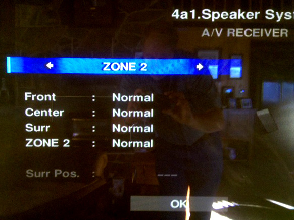

I did make some progress. I found the manual speaker setting for zone 2 and now
can control the zone 2 volume from the iControlAV app. Still no change or control
in the zone 2 virtual volume control in Indigo though.
Carl

What setting did you change on your receiver to allow zone 2 volume control with iControlAV? I'd like to try reproducing the problem. Which receiver model are you using?
It might also be helpful if you could enable debug logging in the Pioneer Receiver plugin configuration, then try to change the volume with the virtual volume controller and paste the logs into your reply.

It's a VSX-1122. When I changed the z2 volume from the virtual volume in Indigo I did see that value pop up in the log for z2
but the volume device value pops back to 100. When off it does show a 0.
The image shows the change I made in the system setup for the speakers to get it to work from the app.
Carl
Pioneer Speaker Select.jpg (132.66 KiB) Viewed 4969 times

@Carl: Thanks for the logs and image. That did help track down the problem. I think I got it fixed in 1.0.3 (at least it's fixed on my 1021, but should also be for the 1122). Let me know how it works for you now.
ckeyes888
Posts: 2438
Location: Kalispell, MT
Re: Pioneer Receiver discussion
Post by ckeyes888 »
Thanks a bunch Nathan...works perfectly!
