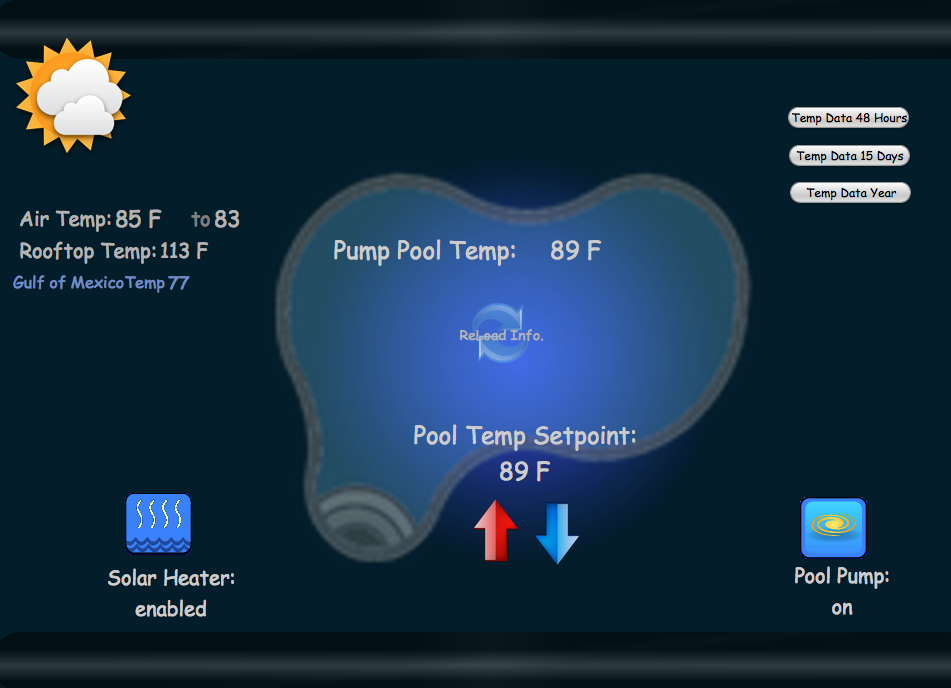

Just of the sake of sharing, here's a couple screenshots showing how I use it to control and track the pool. First is a control page:
Pool control page
Pool control page
Screen Shot 2014-04-06 at 2.05.55 PM.png (224.79 KiB) Viewed 9972 times

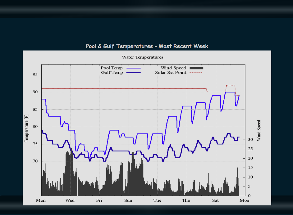

Also, have combined this with the IndigoPlot plugin to generate some interesting pool temps v. Gulf of Mexico temps (along with wind speed and pool heat set point.) You can see in this graph when I turned off the solar heater for a few days and the pool closely paralleled the Gulf temp. (The flat temps in the pool are due to the fact that the pump turns off at night, so IndigoPlot thinks the temperature is constant until the pump restarts and updates the temp in the morning).
Gulf v. Pool temp graph.
Screen Shot 2014-04-06 at 2.12.43 PM.png (114.74 KiB) Viewed 9972 times
