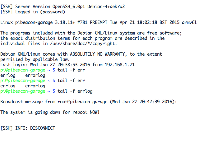

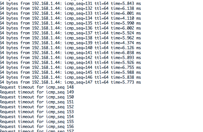

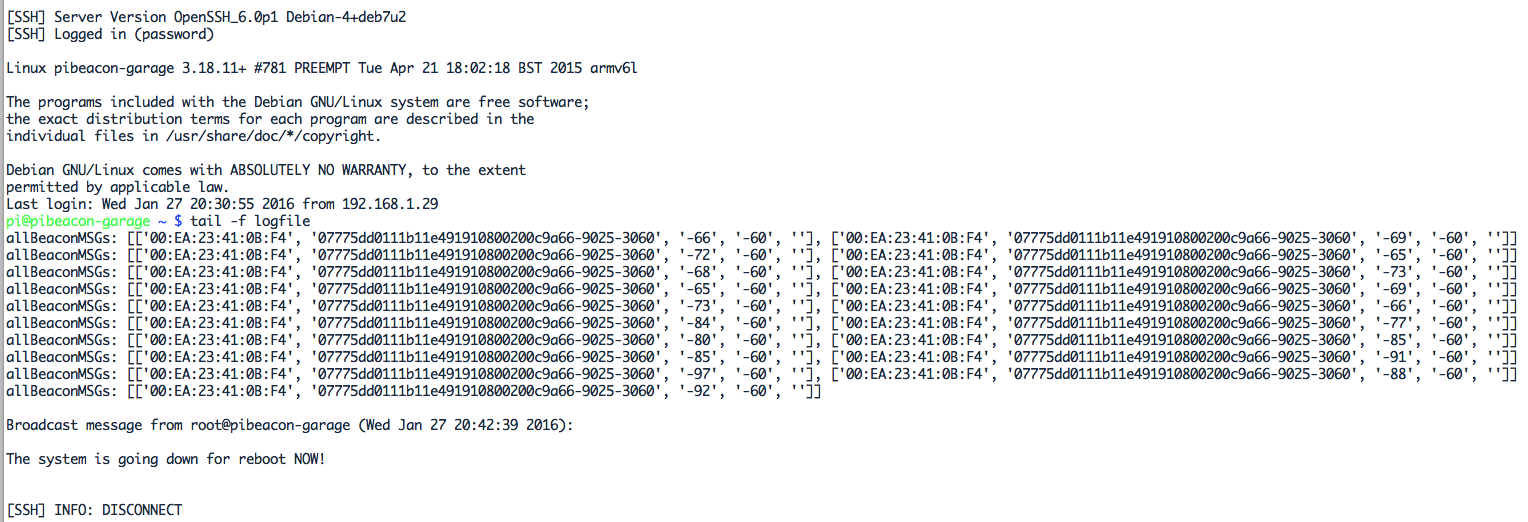

I did the test again with logging enabled and tailing the logfile and errlog. Both attached.
After booting the rPi I waited for the rPi to notice the iBeacon. After that I went away from the rPi. After about 6 mins the rPi reboots.
The error log is empty.
Wouter
Wouter

the log print out looks normal,
why does the ping stop( timeout...)? is this when the rPi reboots?

I did some testing. After the last device disconnects the file "alive" does not get updated anymore, the logging stops, no errors on the errlog.
During this period ping is running without errors.
If an bluetooth device is detected the file "alive" is updated again.
Hope this helps.
Wouter
