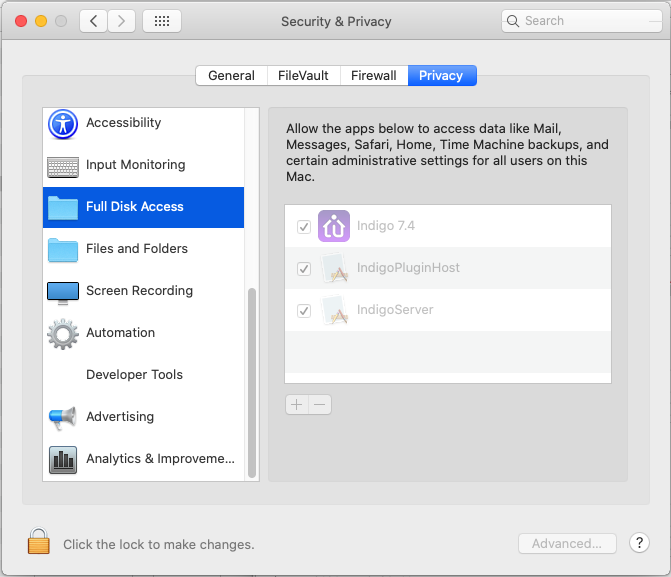

I've already enabled Full Disk Access permission, so I'm not sure what could be responsible.
Full Disk Access
Full Disk Access
Screen Shot 2020-02-17 at 2.40.07 AM.png (77.84 KiB) Viewed 8027 times

None of those are necessary. You might have to add the iMessages plugin though (I don't use it myself so I don't know if that'll work). I don't expect adding full disk access will make it work however since the error implies that it can't send AppleEvents (not access the disk).
Apple has now officially gone off the deep end (what Windows did years ago) when it comes to "security". I suppose their theory is that if the user can't do anything useful then the system is inherently "secure". Might as well just turn off the network, disconnect the keyboard and monitor... :( :? :cry:

https://applehelpwriter.com/2018/09/24/ ... le-events/
The above seems relevant to me, which suggests allowing full disk access to the correct apps (double check version as per Matt's post) would be the way to resolve.
