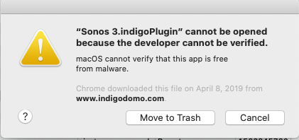

Upgraded my Mac Mini to Catalina and it went well for most of the Indigo server and its plugins except for the Sonos one, Sonos.IndigoPlugin version 1.0.15
None of the scenes or devices using the Sonos plugin would work.
The MacOS (and not the Indigo server) pops up a message asking to Move to trash or Cancel loading Sonos.IndigoPlugin because "the developer cannot be identified". (See attachment).
I hit Cancel and the message pops up again. When I cancel again few times it stops appearing. Only at that time all scenes using the Sonos plugin would work.
But moments later, the MacOS message pops up again. Any scheduled scene using the Sonos plugin will evidently not work until I log on to the Mac hosting the indigo server, cancel the message few times and then execute the scheduled scene manually.
Any solution?

From the Terminal try clearing the quarantine bit from the extended file attributes:
You'll need to enter your macOS password for the command to complete.
sudo xattr -rd com.apple.quarantine /Library/Application\ Support/Perceptive\ Automation/Indigo\ 7.4/PluginsRe: MacOS Catalina rejects Sonos plugin
Thank you so much Matt for the quick response and the solution.
It worked!
To certify resolution I even restarted the Indigo server, later the Mac, waited for scheduled actions ... All went well, everything works as usual and no more message.
Case closed

I’ve seen this on my Doorbird plugin and the Pushover plugin on a new Mac. After getting the message I went to settings -> security and privacy and there was a message that the plugin had been blocked. I ok’d the message and restarted the plugin. This worked for both plugins.

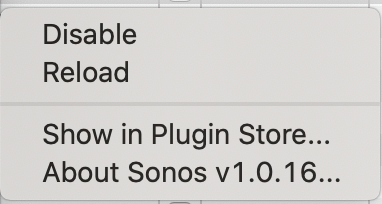

I can't get Sonos plugin to work any more. It was working until a few days ago. I have been on Catalina since it was available so doesn't seem like that would be the problem. I have downloaded and installed the plugin multiple times. I notice the Configure option is missing from the menu. Also did Matt's terminal command. Here is what I am getting....
Error plugin "Sonos.indigoPlugin" is missing file: /Library/Application Support/Perceptive Automation/Indigo 7.4/Plugins/Sonos.indigoPlugin/Contents/Info.plist
- Screenshot 2019-12-11 17.27.04.png (114.8 KiB) Viewed 6590 times
