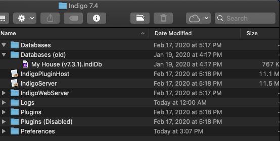

Whoa, check this out on my old machine.
There's nothing in the Databases directory, and an old 7.3.1 db in the Databases (Old) directory. Where did my database go? I can probably get it back using Time Machine, if it that will work.
- Nothing in the Databases directory!
- Screenshot 2020-03-19 at 8.58.06 PM.png (66.23 KiB) Viewed 2683 times

Another clue -- the Events in the Logs folder are up to date, showing stuff right up until I shutdown Indigo on the old iMac server.
Just checked Time Machine, and there's nothing in Databases going back to January 22 of this year -- I must've done an update then, because it doesn't look like there was anything before that in 7.4.

Then you probably moved or created your database elsewhere (Indigo doesn't force the DB into the Databases directory, like any other Mac app you can put it anywhere). If you can still start Indigo up on the current Mac, you can Command-click the DB name in the Home Window (just like any Mac app) to see where the DB file is located. If not, check the Documents directory in the home folder for the user under which Indigo is installed and runs.

Brilliant! That was it.
The 2 machines both used the same file location, so while I couldn't start up the iMac (I'd already moved my license), I was able to get a clue off the Mini. I shutdown Indigo on the Mini, renamed the old file on there, and then copied the correct one from the Mac. Restarted, et voilà! Success!
