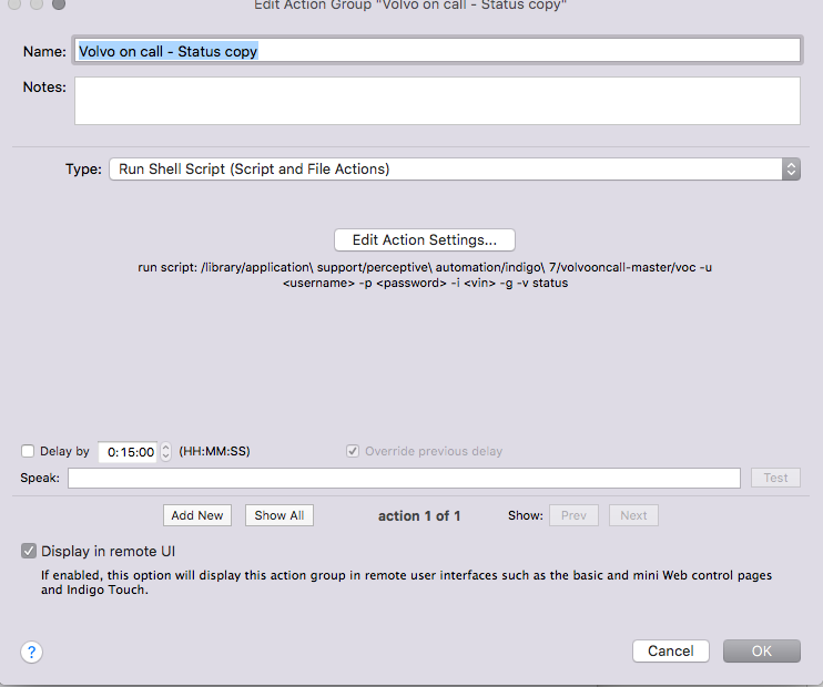

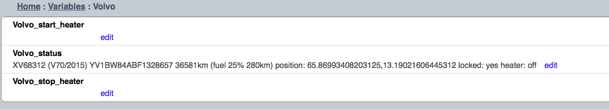

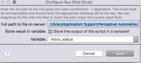

now I can start the heater, stop heater, unlock, lock. But how can I get the status in an variable in indigo? I get some of it, but not all of the status message. look at the pictures

Re: Volvo on call
I suspect all the status is there in the variable, just not visible because as you can see in the terminal screenshot, the rest is on a new line. Put your cursor into that variable and press Cmd+A or Option+A (whatever the correct mac shortcut for "select all" is) then Cmc+C or Option+C (copy) - then open textedit or suchlike and paste in the clipboard - see what content you get?
Your best bet is for someone to knock this into a plugin for you but I don't have time right now - though I'd be happy to do it eventually.
However you should be able to have another script in Indigo itself that parses the value from that variable and puts it into new variables for you. That will be the quicker/easier way forward for now.
Peter
Peter

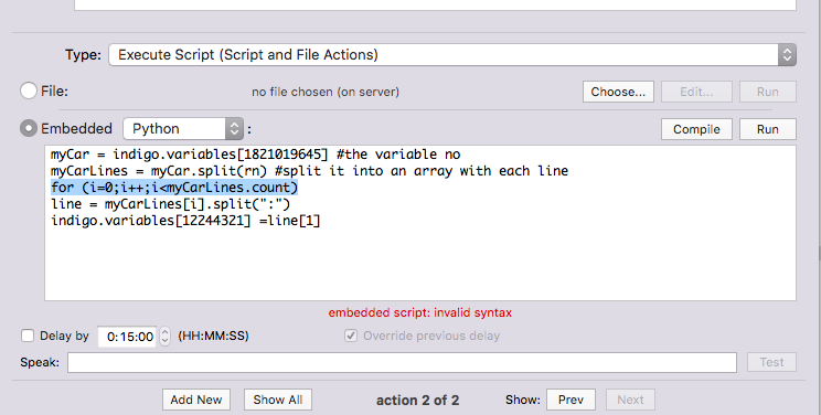

Volvo on call
The command you ran in the terminal must be different to the one in your indigo "run script" command?
Notice fuel isn't showing in the terminal but address is.
The new script would be along the lines of the following but it's completely made up code (based on php), unchecked in any way:
myCar = indigo.variables[1234678] #the variable no
myCarLines = myCar.split(\r\n) #split it into an array with each line
for (i=0;i++;i<myCarLines.count)
line = myCarLines[i].split(":")
indigo.variables[12244321] =line[1]Sent from my iPad using Tapatalk Pro

9. okt. 2017, 23:32:02
Script Error embedded script: unexpected character after line continuation character
Script Error around line 2 - "myCarLines = myCar.split(\r\n) #split it into an array with each line"
Script Error embedded script: invalid syntax
Script Error around line 3 - "for (i=0;i++;i<myCarLines.count)"

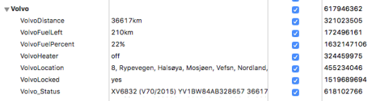

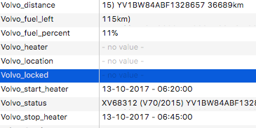

Re: Volvo on call
Right.
Create yourself 6 variables as shown in my screenshot - doesn't matter what names you call them. You will need the variable IDs after you've created each one.
Then paste this script into your Execute Embedded Script action:
v = indigo.variables[000000].value #replace 00000 with your Volvo_Status variable ID (this variable already exists so don't recreate it)
vs = v.split('\r\n')
kmpos1 = vs[0].find('YV1BW84AB328657')+16
kmpos2 = vs[0].find('km')+2
vdistance = vs[0][kmpos1:kmpos2]
fuelpos1 = vs[0].find('fuel')+5
fuelpos2 = vs[0].find('%')+1
vfuelpercent = vs[0][fuelpos1:fuelpos2]
vfuelleft = vs[0][fuelpos2+1:-1]
vpos1 = vs[1].find('(')+1
vlocation = vs[1][vpos1:-1]
lockedpos = vs[2].find(':')+2
vlocked = vs[2][lockedpos:]
heatpos = vs[3].find('heater:')+8
vheater = vs[3][heatpos:]
indigo.variable.updateValue(11111,vdistance) #replace 11111 with your Distance variable ID
indigo.variable.updateValue(22222,vfuelpercent) #replace 22222 with your FuelPercent variable ID
indigo.variable.updateValue(33333,vfuelleft) #replace 33333 with your FuelLeft variable ID
indigo.variable.updateValue(44444,vlocation) #replace 44444 with your Location variable ID
indigo.variable.updateValue(55555,vlocked) #replace 55555 with your Locked variable ID
indigo.variable.updateValue(66666,vheater) #replace 66666 with your Heater variable ID- Attachments

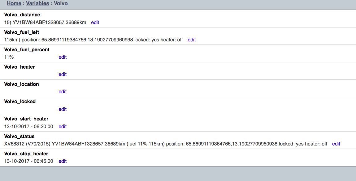

mortenkols
- Posts: 198
- Joined: Wed Oct 29, 2014 2:02 pm
- Location: Norway
Re: Volvo on call
Thanks for helping!!
I have done what you said. But it returns error in the log.
Action Group Volvo on call - Status
Script Error embedded script: list index out of range
Script Error Exception Traceback (most recent call shown last):
embedded script, line 13, at top level
IndexError: list index out of range
Action Collection Error Script /Library/Application Support/Perceptive Automation/Indigo 7/volvooncall-master/voc exited abnormally with a return code of: 1
I tried comment out line 13, then this error
embedded script, line 14, at top level
I tried comment out line 14, then this error
embedded script, line 16, at top level
I tried comment out line 16, then this error
embedded script, line 17, at top level
I tried comment out line 17, then this error
14. okt. 2017, 11:08:31
embedded script, line 19, at top level
I tried comment out line 19, then this error
embedded script, line 20, at top level
When i comment out all the lines with error, these variables got updated.
- Skjermbilde 2017-10-14 kl. 11.14.02.png (35.35 KiB) Viewed 4784 times
mortenkols
- Posts: 198
- Location: Norway
Re: Volvo on call
Variables in the browser
- Skjermbilde 2017-10-14 kl. 11.20.31.png (94.27 KiB) Viewed 4782 times
Re: Volvo on call
Add this to the bottom of your script then copy the output from your Log
indigo.server.log(u"Status: %s" % (v))
