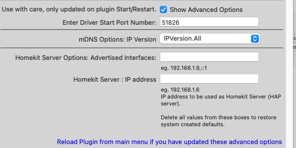

At a guess will be something in the advanced options panel (whether you meant to have it there or not). This is the HKLS Plugin Config page - advanced options.
Do you have any logging - for example 0 HomeKit devices started. This is often the error when something in advanced config is wrong. A network adapter that doesn’t exist etc..
I have upgraded 2 systems without problems. And on the test system did have to test a lot of advanced options - to make sure was all going.
Let me know what you have in there…
Won’t break any config things once going (well shouldn’t…)
I suspect you have something entered in advanced config that you perhaps shouldn’t? (defaults or all empty would be ideal)
Glenn

So in .21 I have it configured to use my server IP and ipv4. I’ve updated to .26 and those settings have.. vanished. I’ve re-populated them, but still nothing.
As for the logs.. all bridges and 166 devices load as normal, no errors in the log.

durosity wrote:So in .21 I have it configured to use my server IP and ipv4. I’ve updated to .26 and those settings have.. vanished. I’ve re-populated them, but still nothing.
@durosity
I did play around with the Advanced option menu and got the same problem as you, the answer is use only IPVersion.All and leave the 2 IP address's under that to nothing, when I filled them in I got the same as you did, no idea what they do but definately not required.
Don't clear the Driver Start Port Number, that is terminal death and needs you to delete the indipref's file before it will start again.
Basically I will be leaving the Advanced Menu alone.

This works for me
[img]
Use with care, only updated on plugin StartRestart. Show Advanced Options.jpg
Use with care, only updated on plugin StartRestart. Show Advanced Options.jpg (50.97 KiB) Viewed 2002 times

Few pointers:
1. Advanced settings - as per the blue down the bottom - to action these you need to reload the plugin and restart it entirely.
2. Best default option is to have completely blank for the 2 boxes which can have IP addresses in them.
3. IP Version will be either IVP.4 or IVP.All - 6 essentially isn’t used for HAP server side. (so no way to be only IVP.6 - after typing this probably should remove it as an option…)
4. Would force restart Home App for good measure
Leaving these IP boxes blank, should work as default for 99% of users.
Not sure why you have IP address in here durosity? (don’t believe it was part of any past troubleshooting)
Can PM me zipped log at startup, with debug pyHAP library bit on.
