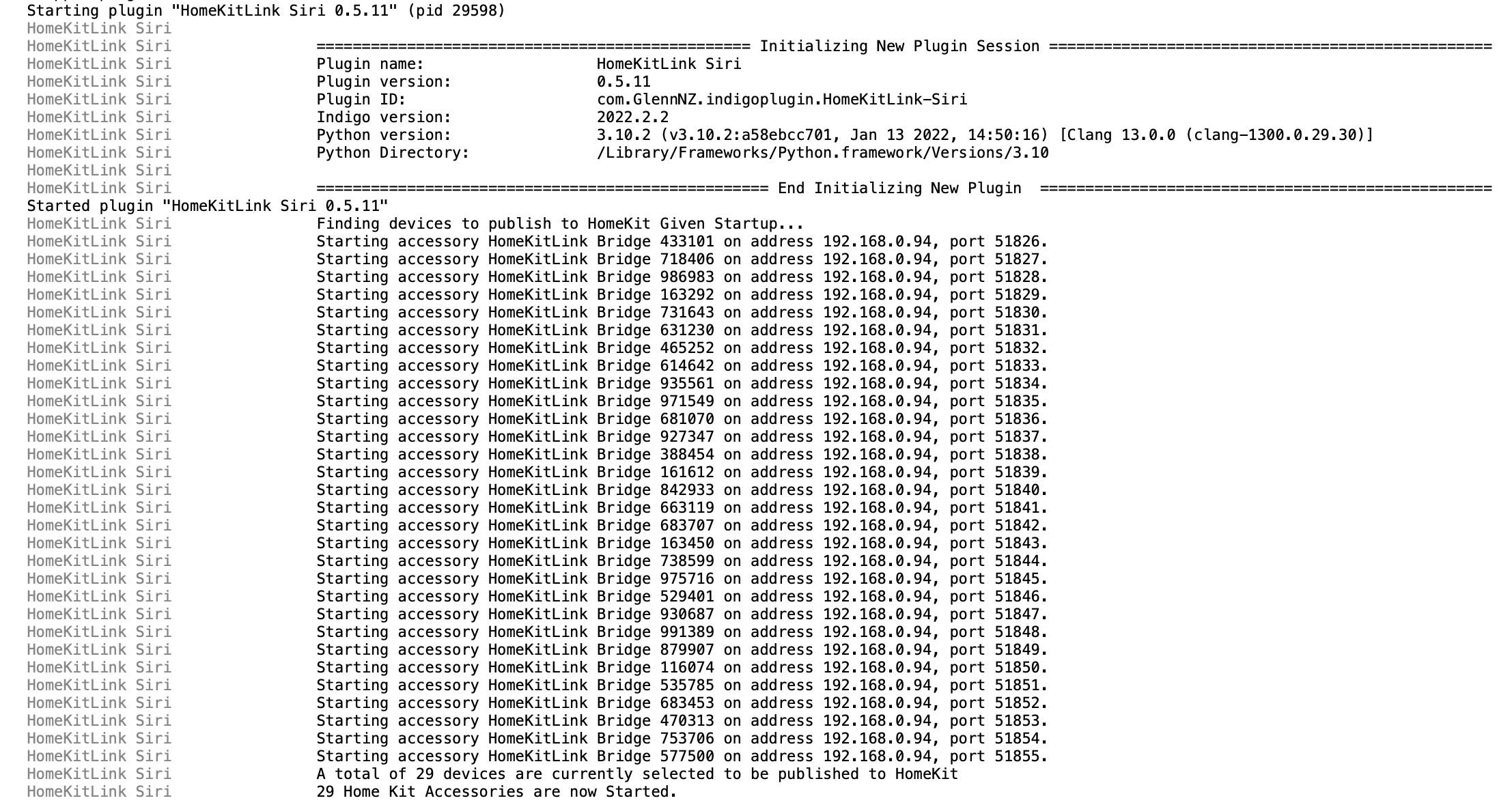

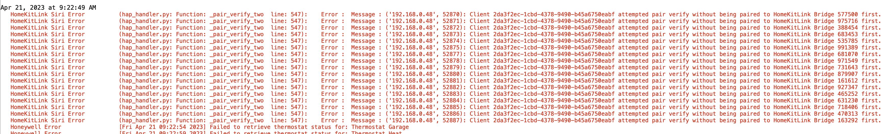

I am also having a similar issue.
Ventura 13.3.1
IOS 16.4 on Devices
Ventura 13.3.1
IOS 16.4 on Devices

But - why do you have some many bridges and only 29 devices?
Every bridge can have up to 99 devices added to it. You don’t need a new bridge for every device you want to add.
It will work - but is adding quite a bit of overhead, driver, bridge driver, thread, zeroconf (in this version) with every bridge…. I would reconsider that approach, and it wouldn’t be recommended. Basically a bridge for a collection of devices - either via room (as some do) or via type, or all in the one. Less bridges == less overhead
The pair_verify error typically means that a Home app client has not been updated to the new Home architecture. Until it does it will not be able to connect to any of the HomekitLink Bridges. This error refers to this unverified client (as on old incompatible version of Home) trying to connect. It fails. You need to track down the client (in this case 192.168.0.48 - from DHCP router lists, or check IP’s of clients. Either upgrade the client if possible, or remove it from the Home.
Thanks for images - will use yours as example.
