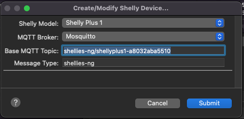

Here are some sneak previews of what the plugin looks like:
Creating a device with the Device Factory (just select the model and the MQTT information)
Device Factory UI.png (32.34 KiB) Viewed 4699 times

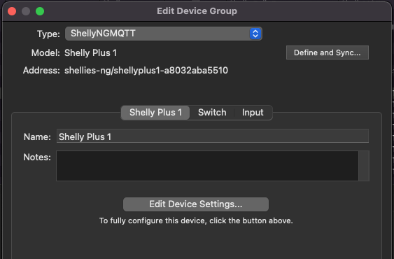

What a "Shelly Plus 1" device group looks like
Shelly Plus 1 Device Group.png (38.91 KiB) Viewed 4699 times

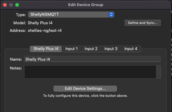

What a "Shelly Plus I4" device group looks like
Shelly Plus I4 Device Group.png (37.66 KiB) Viewed 4699 times

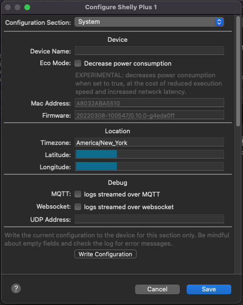

System configuration UI for all main devices
System Component Configuration.png (72.65 KiB) Viewed 4699 times

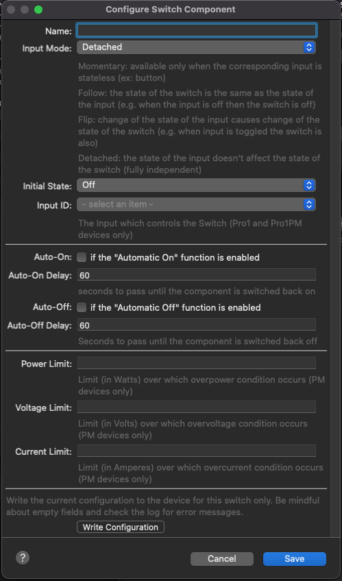

Switch configuration UI
Switch Component Configuration.png (108.96 KiB) Viewed 4699 times

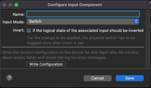

Input configuration UI
Input Component Configuration.png (38.84 KiB) Viewed 4699 times

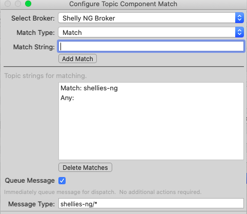

Not having any joy with this yet using an i4... It's probably me!
For cleanliness I created a new broker for NG devices.
My prefix is: shellies-ng/shellyplusi4-1921681134
New trigger seems to be working as I get confirmation in the log, yet my i4 device is not connecting.
Any suggestions?
Screenshot 2022-05-01 at 15.52.42.png (44.58 KiB) Viewed 4638 times
aaronlionsheep
Posts: 263
Joined: Sun Feb 24, 2019 7:09 pm
Re: Interest in Next-gen Shelly Devices
Post by aaronlionsheep »
Colly wrote:Not having any joy with this yet using an i4... It's probably me!
Any suggestions?
Ah, no it is not you. A good portion of the main I4 device code was left out (maybe I was up too late). I will have that added back shortly.
