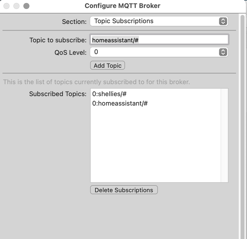

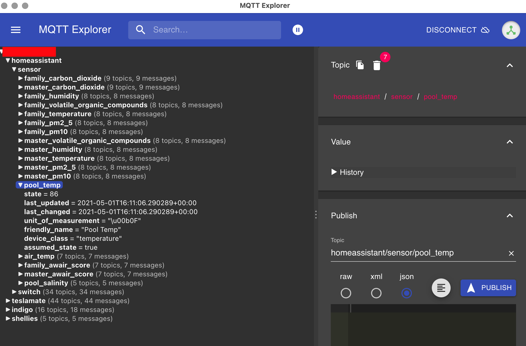

I got Home Assistant devices publishing to MQTT and Indigo devices publishing to MQTT. I can access and create interactions with all those devices using with Node-Red. However, for the life of me, can't get MQTTShims to work. The first image is the MQTT Explorer with the topic I want to use with MQTTShims.
The process I attempted, with the images in sequence, was:
- Configured the broker with the Topic Subscription

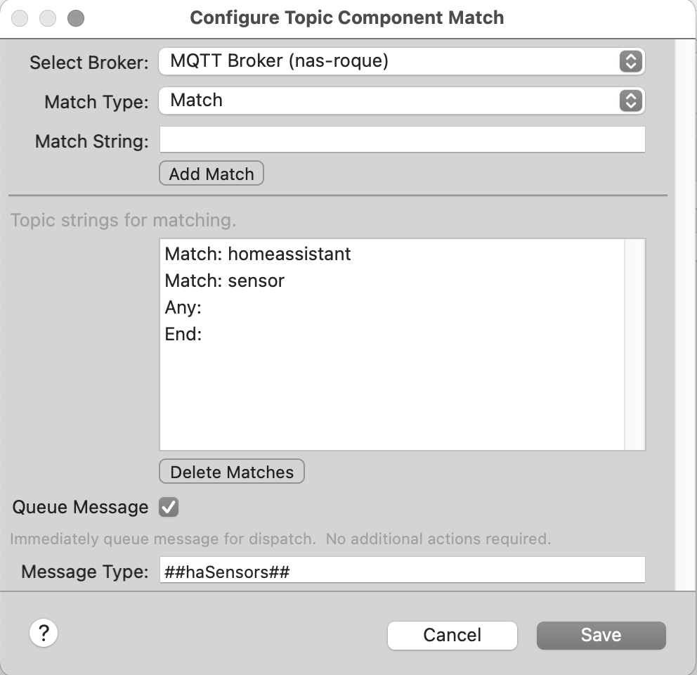

- Configure the trigger

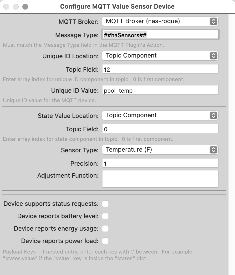

- Configure the device

MQTT Explorer is messing with you.
The topic for the pool temperature is: homeassistant/sensor/pool_temp/state
And it's a raw payload type.
Your subscription is fine.
Your Component Match is wrong because you're not accounting for the "state" component after the unique ID. Add a "state" term before the end term.
Your Unique ID location is correct as "Topic", but the value is 2 not 12. It's the third component in the topic string, and it's a zero-based count.
The State Value Location is Payload, not Topic. And it's a RAW payload (not JSON).

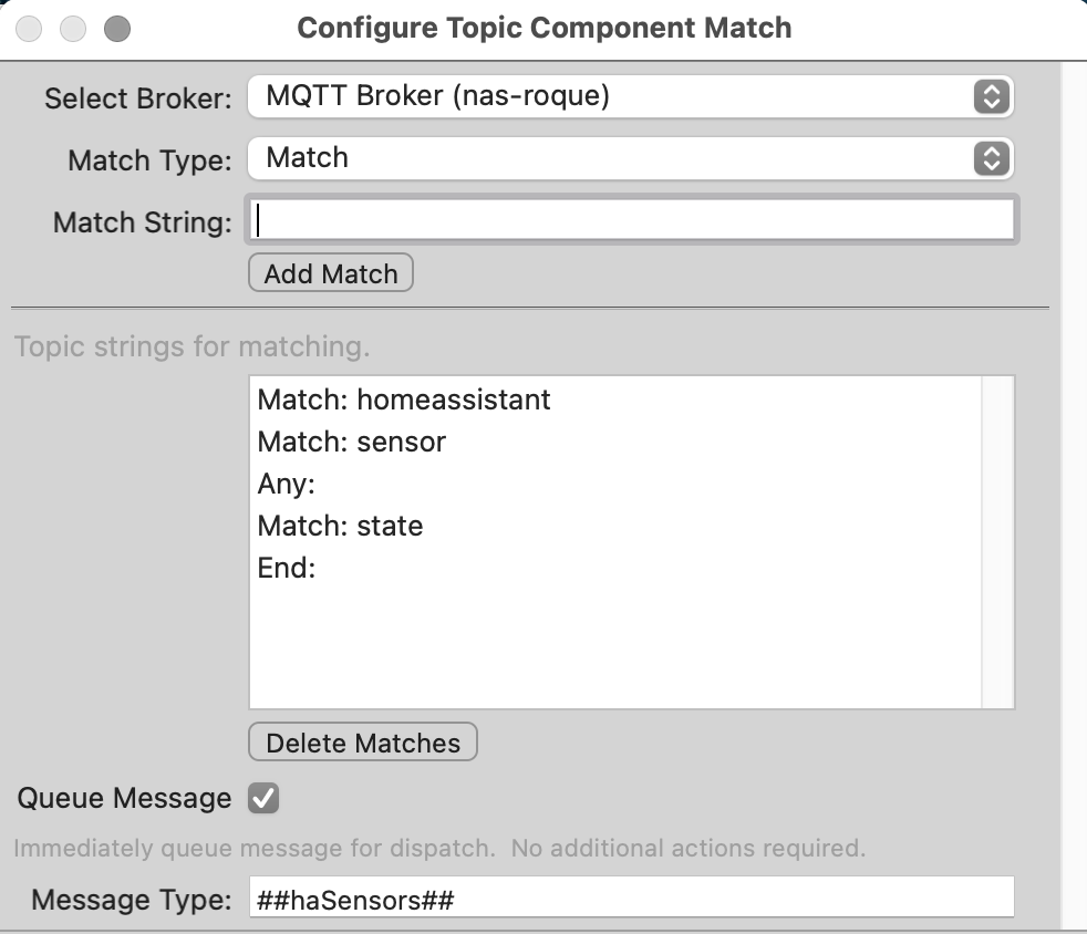

I got the Component Match fixed with your suggestion. However, I still can't get the device to work. is the "Unique Value ID" correct the way I have it? That is the only thing that you didn't mention.

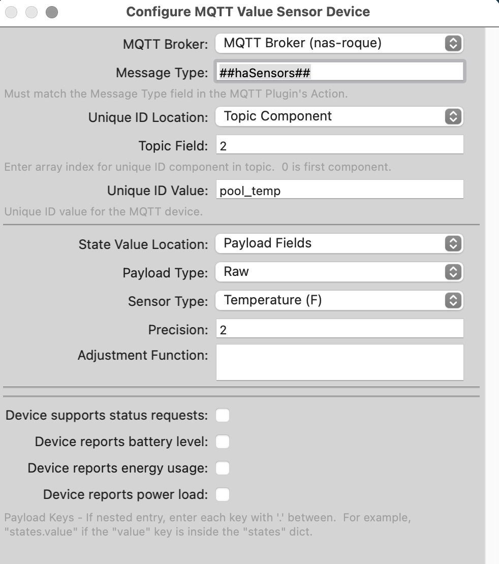

- Screen Shot 2021-05-01 at 3.27.09 PM.png (14.26 KiB) Viewed 2262 times
- Screen Shot 2021-05-01 at 3.21.50 PM.png (161.63 KiB) Viewed 2262 times
- Screen Shot 2021-05-01 at 3.21.20 PM.png (98.43 KiB) Viewed 2262 times
Re: MQTTShims setup - feel really dump right now
My system is afraid of you! No sooner I had sent the post, it started working.
Thank you!!
JP
Thank you!!
JP
