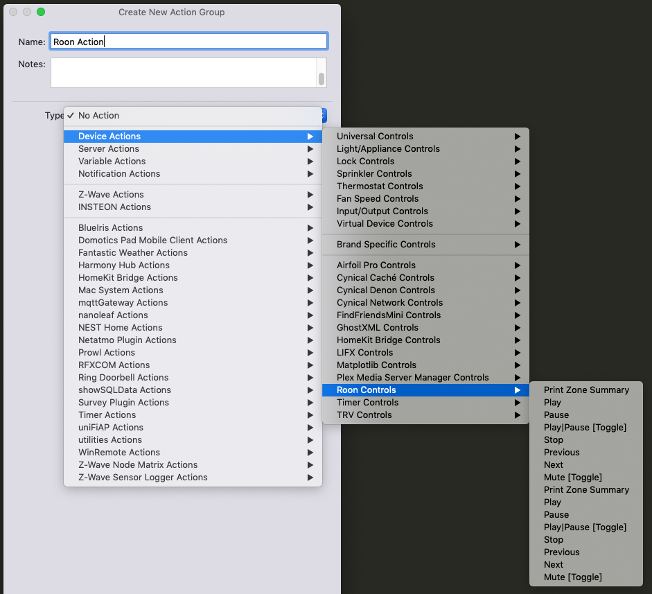

Another missing piece of info about Roon Actions; these are available here;
Roon Actions
Roon Actions
Roon Actions.png (494.52 KiB) Viewed 23035 times
Still trying to figure out why the Actions are duplicated. :?
Only one of the pair will show a zone to select. So use that one.
In the meanwhile, I will try and figure out what is going on. :)

Of interest I didn't get the duplicated Actions in your screen shot. Not sure if you had fixed that in this version?
Sam.

The duplicated actions were caused by me having duplicate Roon actions in another unrelated plugin - I was using the Roon code as a base - I have now sorted this on my system and it explains why you aren't seeing it. :)
