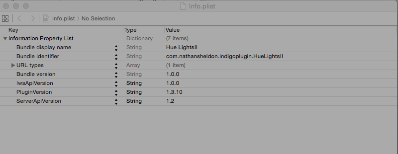

I tried to change the plist with Xcode as suggested. But I received the following error when the plug in was trying to install in indigo.
Feb 3, 2015, 3:52:41 PM
Installing and enabling plugin "Hue LightsII" v1.3.10
Error ReloadPlugin() caught exception: FileIOError -- cannot move: destination file exists
Error (client) UpdatePluginStatusUI() caught exception: IllegalParameterError -- illegal XML tag name character
Any idea what went wrong?
Thank you,
Carlos
Thank you,
Carlos

Within info.plist, there are three keys that need to be edited in addition to renaming the base plugin file name:
CFBundleDisplayName
CFBundleName
CFBundleIdentifier
I only see two in your screenshot. Perhaps XCode is managing the third automatically; not sure as I edit plist files by hand.
Sounds like you may have it working though. Good luck.
Cheers,
Dave
CFBundleDisplayName
CFBundleName
CFBundleIdentifier
Cheers,
Dave
