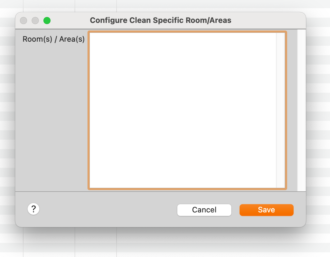

Rooms are missing from edit action settings, how should get them back? I have tried updating maps for both bots, but that is not working.
- Screenshot 2023-09-22 at 2.14.10 PM.png (255.52 KiB) Viewed 2440 times

Hey Glenn, you're right- I looked back at my original post and was embarrassed
I have a pair of S9+ robots.
Currently on plugin version 0.9.20
What happened: I have been using rooms/areas feature, embedded with actions and connected to SIRI for a super long time. One day a month or 2 ago, my wife (who I can't get to believe that automation actually works lol) asked siri to vacuum Kitchen. The roomba went anywhere but the kitchen, seemed lost and ended the mission. that's when I checked the action settings and discovered that the rooms/areas list is blank.
I have checked the debug logs, everything else is working and updating as expected. I am as well getting this message:
Do you suspect that this could be the issue?
CognitoIdentityCredentials is not authorized to perform: execute-api:Invoke on resource: arn:aws:execute-api:us-east-1:********9246:6gtg8429qe/dev/GET/dev/v1/4BCD3A164F4D4D599C151D9BAD9185CE/pmaps"Re: Rooms are missing from edit action settings

The issue appears to be iRoomba has now blocked access to the room/pmaps data for our accounts. The use an Amazon Web Service and this is the error message received in that scenario.
Unfortunately that leaves us a bit stuck to get room data. Eventually after running a number of manual room commands the data will slowly populate - but that is piecemeal and doesn’t work that well. Hence pulling it from the cloud was a far better immediate solution.
Other libraries - haven’t reported this as yet that I can see. So I will double check my endpoints and check they are uptodate (which they do seem to be…)
Best option is to use Save Last command plugin action Group.
Run clean room command - or cleans rooms - whatever you want.
Create new Action Group in Indigio
iRoomba plugin - Save last command
Select iRoomba and press appropriate button.
This recalls that command you just run, and saves it permanently into that action group. So when you then run this Action Group it will perform that command - ‘clean Kitchen’ or whatever it was.
Repeat the above as needed for each room/area you wish to have a command to clean.
You will need to do this for the set of rooms you want - but once done - unless you edit or change the map manually should be set.
