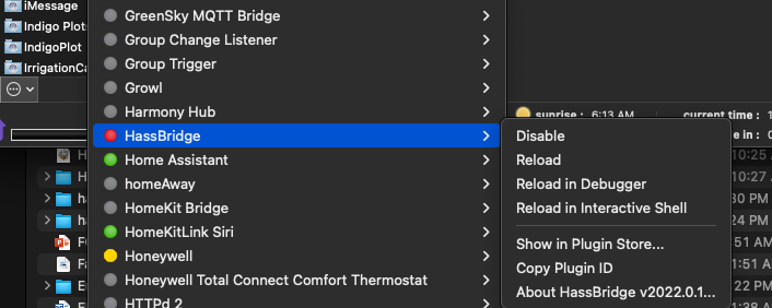

The only thing that I need to mention is that the configuration menu option does not show up if the plugin is stopped. I had to load the old plugin... uncheck the customization file and then relaod the new plug-in. My guess this is just a programming issue that can be corrected so that is someone types in the wrong file location in the next version of the plugin, then they do not have to install the old version to correct the error I made.. I included an image of the configuration menu item not appearing.

- Posts: 7830
Re: HassBridge plugin updated for Python3
I still want to know what's in that file.
