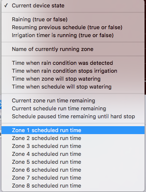

Did you install 1.3.0 last night? Go to Plugins -> EPS Device Extensions -> About, is it 1.3.0? Because I added exactly what you had suggested into the plugin yesterday (see screenshot below). Those new states take into account if a schedule has been passed to the device or not - so if you don't pass a schedule then these values represent the Max Watering Times as you defined in the sprinkler device, if you DO pass a schedule then they represent the scheduled times. Basically it's to say that these states are always something, be it the current schedule or the default, all depending on if you passed a schedule or not.
1.3.0 States
1.3.0 States
Screen Shot 2016-06-10 at 1.49.57 PM.png (95.44 KiB) Viewed 6388 times

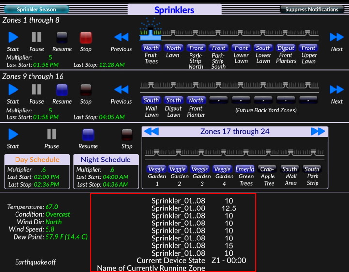

Thanks for the information. I made another pass at getting the irrigation controller to work. After running the sprinklers on the first night, last evening I installed a text field for each of the 8 "zone x scheduled run time" fields and then had a look at the times reported; they all reported the maximum duration time (which I have currently set to 60 minutes). Then, I opened up the Irrigation Extension device which I created two nights ago (version 1.3.0) and looked to see if there were any options which I had missed... I didn't see any, but as luck would have it, just closing the device's "Edit Device Settings" window caused an update of the actual times on my 8 zones and the text fields reported {10, 12.5, 10, 10, 10, 10, 15, 10} but individual values laid out for each text field. The brackets I show here are just my way of telling you about it. The actual times in the sprinkler schedule are {20,25,20,20,20,20,30,20} but due to the time of year, I'm using a sprinkler multiplier of 0.5 so it looks like the zones updated correctly.
Here is the bad news: I changed a couple of the watering times to test it in live mode and then I executed the schedule manually from Indigo. The values did not update. Furthermore, I tried out some of the other fields: Current device state reported Z1 - 00;00, Name of currently running zone was blank, and Current zone run time remaining was 00:00 (In the attached picture I accidentally chopped off that string at the bottom of the list... but it's there).
So... it's not reporting my schedule in real time. In the picture I've included you can see the zone running (see the new variables below the sprinkler section with a red box around them, where I laid them out temporarily in order to try out the new irrigation extension). Could it have anything to do with me having 3 EZFlora's? Any suggestions on how to get it to update live?
I've only installed one Irrigation Extension so far for zones 01 through 08. If I can get that one working I'll integrate things properly and do all three EZFlora's. Thanks again for writing it and hope I can get this going. Will be able to try again this evening... motherinlaw is turning 90 today... family party. Thanks in advance. :)
-Al
Colorado4Wheeler
Posts: 2794
Location: Colorado
Re: Device Extensions Released
Post by Colorado4Wheeler »
I'll do some testing and see if I can replicate the problem, if so then I should be able to fix it for you.
Cool UI, I like the sprinkler indicators :)
Check Them Out Here
