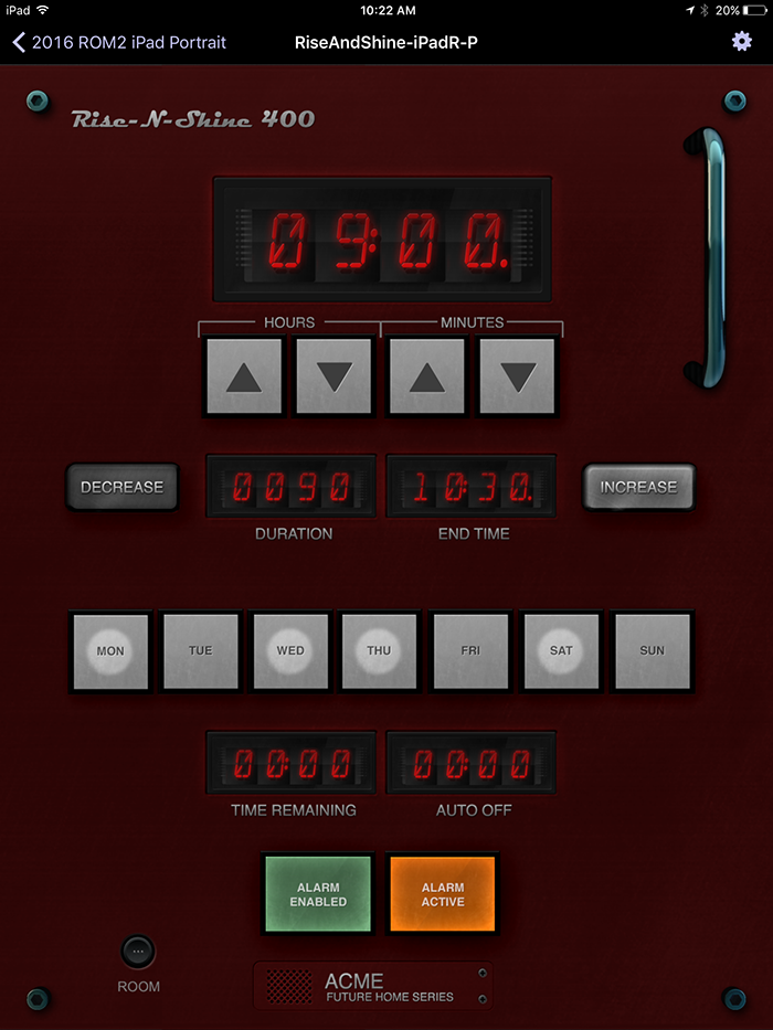

It does not have a snooze, I had considered adding this feature (and it would be quite simple to add) but when you consider the amount of effort required to wake up, grab your phone (or iPad), unlock it and tap the "snooze" graphic, you are likely wide awake :). Then again you could tie the snooze to a Insteon button pad instead... Let's put a pin in that for "if people ask for it".
This screen shot is just an example of how it can be used on a control page, the graphics are NOT part of this plugin!
ROM RNS Screenshot

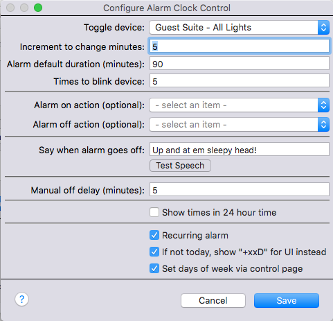

Configuration and Use
Simply add a Alarm Clock device for each alarm you want to have and set the options.
Device Config
Device Config
Screen Shot 2016-06-08 at 7.26.48 PM.png (69.03 KiB) Viewed 16742 times
Indigo Device View
Indigo Device View
Screen Shot 2016-06-08 at 3.29.40 PM.png (21.66 KiB) Viewed 16888 times
Options:
  • Toggle Device: Any Indigo device that supports On/Off, including virtual device groups
  • Increment: How many minutes to add or subtract each time an Increase/Decrease Minutes is called or Increase/Decrease Duration is called
  • Alarm Default Duration: How many minutes until the Toggle Device is turned off automatically
  • Times to Blink: As soon as the alarm time is reached the plugin will blink the Toggle Device on and off this many times. Enter zero if you don't want to blink
  • Alarm On / Alarm Off Action: Optional action groups to execute when the alarm goes off or when it shuts down (or both)
  • Say: What to say through Indigo when this alarm goes off. Leaving this blank will disable this feature.
  • Manual Off Delay: How many minutes to wait after someone has manually turned off an active alarm before the lights go out. For example, you have a default duration of 60 minutes - this means in 60 minutes the Toggle Device is turned off - when someone manually turns off the alarm in, say, 30 minutes then the devices will stay on for this many more minutes to give the person time to clear the room before it is turned off. You can enter zero here if you don't want to use this feature
  • Show Time in 24 Hours: As it implies, instead of showing the alarm time at 01:00pm it will instead show as 13:00
  • Recurring Alarm: Whenever this alarm is turned off (manually or automatically), if this option is checked then it will automatically schedule the next alarm according to the other settings (i.e., tomorrow or the next instance of a day selected for days of week)
  • If Not Today Show +xxD: If this is disabled then the countdown to alarm / countdown to alarm off / Indigo device list text will show HH:MM. If this is enabled these displays will instead say, for example, "+01D" to let you know the alarm is more than a day away, once it is less than 24 hours it will revert to HH:MM again.
  • Set Days of Week Via Control Page: When enabled the days of the week the alarm will enable is set purely from the control page (and thus read from states), when disabled you can select which days of the week the alarm will enable (thus read from props). Changing this setting effectively ignores the the alternative option
  • Days of the Week: Optionally select which days of the week this alarm will enable on. This is to say that if you turn ON the alarm on Monday and you have selected Wednesday on this list then the alarm will schedule for Wednesday and not today. Also for recurring events this list is used to determine the next occurrence of this alarm

As already stated, this has been optimized to use with control pages, so it has a number of actions to tie your control page graphics to:
  • Increase / Decrease the hour and minute of the alarm
  • Increase / Decrease the auto off time
  • Select which day(s) of the week to enable the alarm
  • Turn the alarm on and off
  • Manually turn off an active alarm
One important action in case things go awry for some reason is Reset Alarm State. If something I haven't quite accounted for happens and the plugin errors out, running this will reset the alarm and turn it off.
Another thing to note is that the readouts will show "HH:MM" or "HH:MM.", the period is there to imitate how alarm clocks add a period to indicate AM or PM. If using 24 hour time this does not show up. This feature was designed this way because it worked quite well when using LCD Creator and looked just like an alarm clock. This only shows up on the alarm set time and alarm off time states, nothing else. If this becomes an issue for some folks then chime in and let me know and I'll see about reworking that, but even if you don't use LCD Creator it should still look good.
The current ROM screenshot is a test image, the next version of ROM will include a special new background for the new Rise-N-Shine 400 device :)

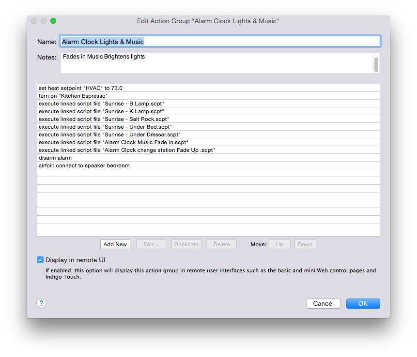

How about adding the option for a simulated sunrise and music fade in? :wink:
I use these scripts for my alarm clock:
Slowly fades music up:
tell application "iTunes"
	stop
	set sound volume to 0
	set nOldSoundVolume to sound volume
	repeat with nSoundVolume from sound volume to 0 by -1
		set sound volume to nSoundVolume
		delay 0.0
	end repeat
	set the_playlist to user playlist "Radio Faves"
	set view of front window to the_playlist
	play track "Fréquencesrelaxation" of playlist "Radio Faves"
	repeat with nSoundVolume from sound volume to 100 by 1
		delay 20
	end repeat
end tell
Slowly brightness lights:
(there are a bunch of these scripts for different lights)
tell application "IndigoServer"
	set deviceName to "Master Bedroom Keypad - B"
	set maximumLightPercentage to 60
	set minutesToSunrise to 30
	-- This math is importaint as it sets the number of repeats below
	set raiseLightsBy to round (maximumLightPercentage / minutesToSunrise / 2)
	log "Starting to raise the lights by " & raiseLightsBy & "% every 30 seconds over the next " & minutesToSunrise & " minutes to achive a final brightness of " & maximumLightPercentage
	repeat minutesToSunrise * 2 times
		-- Turn up the brightness of the device one increment
		brighten deviceName by raiseLightsBy
		-- Set a variable with the current brightness of our device so we can log it below
		set currentBrightness to brightness of device deviceName as integer
		log "Sunrise Simulator raised " & deviceName & " to " & currentBrightness & "%"
		-- Since the parameter minutesToSunrise is in minutes, delay one minute
		-- but loop every 30 seconds to give it a more even increase in
		-- brightening. Note the "minutesToSunrise / 2" and "repeat minutesToSunrise * 2 times"
		-- above to account for the half minute increment.
		delay 30
	end repeat
	-- In case there is a rounding error above, set it to the target percentage
	brighten deviceName to maximumLightPercentage
end tell
Changes iTunes to a chosen station after a 15 min or so:
	repeat with nSoundVolume from sound volume to 0 by -10
		delay 0.5
	end repeat
	play track "CBC Radio One Winnipeg" of playlist "Radio Faves"
		delay 0.5
	end repeat
	play
end tell
Screen Shot 2016-06-08 at 5.32.34 PM.png (98.3 KiB) Viewed 16771 times

I had briefly considered adding in onAlarmOn and onAlarmOff to let you call Action Groups but it is a duplication of the same functionality I have in Scene Toggle and since this plugin supports that one I figured that would be a no brainer.
That being said I could do is add the action group calls to the program quite easily.
Check Them Out Here
Colorado4Wheeler
Posts: 2794
Location: Colorado
Re: New Plugin: Alarm Clock
Post by Colorado4Wheeler »
Updated!
1.1.0 now has action group calls as an option. At least in the meantime you can use that for your music and simulated sunrise/sunset until I think of good ways to integrate those in without rewriting the plugin :).
Screenshots and documentation updated as well.
