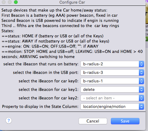

1. create a device plugin = pibeacon, type = CAR, eg Volvo or Moms car ...
2. select
(A) a battery type beacon (i.e. with AAA battery), place that beacon in the CAR (fixed)
(B) a USB powered beacon put into USB output in CAR
(C) 0-3 beacons attached to your car keys (eg xy)
Screen Shot 2017-01-15 at 22.43.36.png (98.22 KiB) Viewed 11102 times

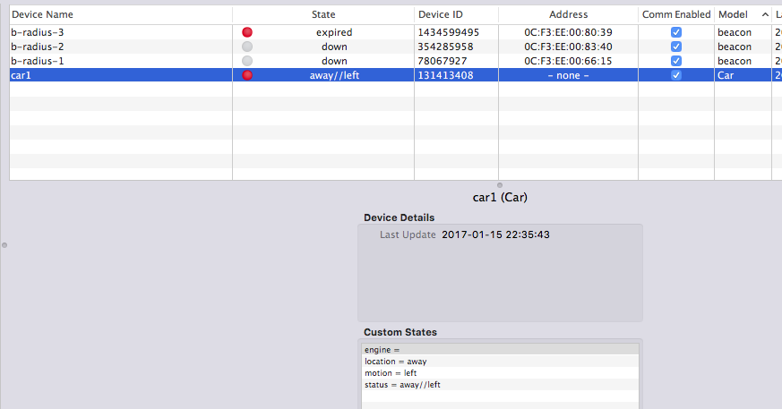

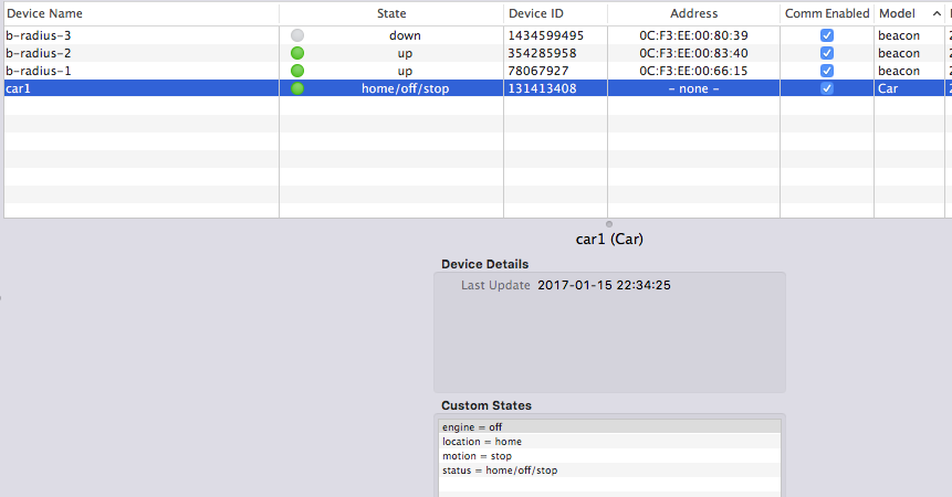

The CAR device will have 3 states with the following values:
(a) LOCATION= HOME/ AWAY
(b) ENGINE = ON/OFF/""
(c) MOVING = STOP/LEAVING/LEFT/ARRIVING
Screen Shot 2017-01-15 at 22.36.27.png (53.88 KiB) Viewed 11102 times
Screen Shot 2017-01-15 at 22.34.33.png (52.97 KiB) Viewed 11102 times
Conditions for the states:
LOCATION:
-HOME: if Beacons A or B or all C are UP (at least one of the beacon is how so the car must be home)
-AWAY: if Beacons A and B and one of C are down (none of the beacons is home)
ENGINE:
ON if beacon B is on
OFF if beacon B is off
"" if STATUS =AWAY
Moving:
- STOP if home and Beacon B = off (HOME and car is off = must be home standing)
- LEAVING if HOME and Beacon B = ON ( car is home and battery beacon or key is on and USB key comes on. = home starting engine --> must be leaving)
- LEFT if AWAY (no beacon visible so car must be gone)
- ARRIVING if AWAY and any beacon on (was away, have detected at least one beacon so it must come home)
