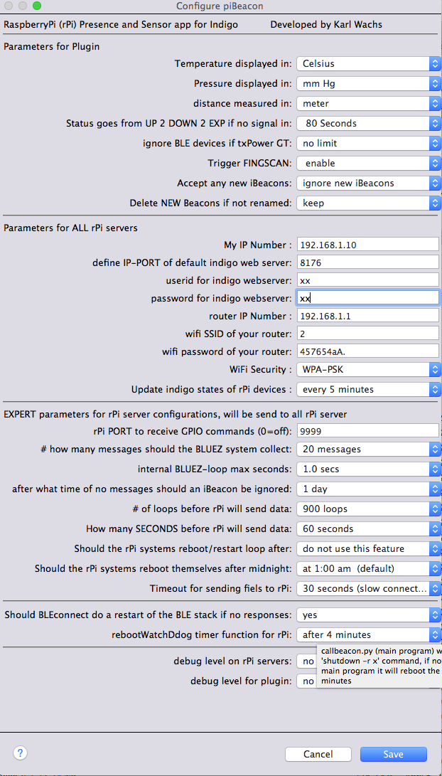

new:
- added x,y,z position calculation for each beacon from the xyz positions of each r-Pi .
You need to assign x,y,z positions to each of your r-Pi (in meter,feet, or yards) (z is for the levels; I am using 5 m for each floor: ground=0, 1st floor=5m. x,y position as the r-Pi's are placed on each floor. - added convenient management functions to ignore drive by beacons
- beacons that send with txPower > 0 dBm (can be set) will be ignored. That would be an extremely powerful beacon with a signal strength of ~ 0.1 Watt at 1 meter distance!
- onetime beacons will be deleted after a day and added to the ignore list
- added fast reaction to beacon signal changes . When the signal received from a beacon by a raspberry is > a set threshold, the messages gets send to the indigo server immediately, instead of collecting messages for 1 minute. this threshold can be set for each beacon
- added a self check on each r-Pi to reboot if no connection to the wifi router after 5 minutes. This is needed in case you have a power failure in your house. The rPi comes back faster than the router and as it can not find the wifi router is just sits there and does not retry to connect to the roster, by rebooting it will try again

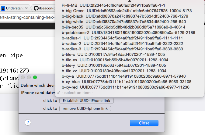

- iPhones can now be used as iBeacon, but the BLE signal gets turned off once it goes to sleep.
you need to e.g. use LOACTE app or install the gem tot app with Xcode your self.
setup the UUID major / minor you like on your iPhone
then in piBeacon do menu/piBeacon/Define iPhone-UUID link select the beacon that was just created by the iPhone with the UUID-Major-Minor you just selected on the iPhone. From then on the rPis will not use the MAC # for that UUID-Major-Minor to id the device but the UUID-Major-Minor and send the indigo pibeaconpldgin always the same MAC number even if the iPhone changes it. - if anything changes the plugin will automatically update the rPis in the background and will retry until all rPis are successfully updated.
- some english improvements, menu help etc.
karl

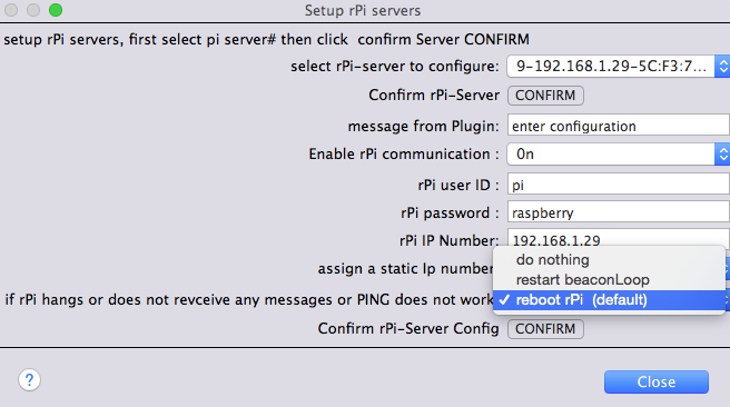

The reboot frequency of the rPis was set to 5 minutes if:
1. ping does connect to your mac
2. if the beaconLoop python program (the one that does all the work) does not update a file "alive" for > 200+ seconds. Beacon loop updates this file tav least once a minute as part of its main loop. It gets updated independently if there is anything to do. it is just an alive signal.
3. now all temporary files- anything that changes is moved to ~/documents/piBeacon/ out of the plugin container. This was done after following the discussion about path to the indigo plugin.
(*) I have one with > 20,000 entries per day. But it is not an beacon, must be my car may be.

Re: piBEACON: presence monitoring download
v 1.5.7 posted
fixed:
typo, 1.5.6 did not start
added:
you now can select what the rPi should do if it thinks it hangs (also if there is NO bluetooth traffic), it checks for 10 minutes then do
1. nothing
2. restart the beconLoop program (that queries the bluez stack for new data and sends to the mac). This is quick ~ 1 second
3. reboot ~ 10-30 seconds
for each rPi individually
fixed:
added:
1. nothing
