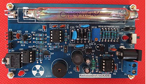

1. added sensor Geiger counter support
use INPUT pulse sensor as input
set deadtime and bounce time to 0
you need to make sure that the RPI does not get 5V to GPIO.
tested w Portable Handle Geiger Counter 0.01 μSv/h DIY Kit Nuclear Radiation Detector With Miller GM Tube Gamma Beta Ray Suit for Arduino
https://www.amazon.com/Portable-Counter ... way&sr=8-5
standard cheap china detector.
with this detector you need to bridge the P100 pins and use the headset output through a voltage devider (2x 4.7K Ohm) as GPIO input
The detector can be connected to +5V/ground from the RPi as power source.
As the signals are ~ 0.5 mSec wide a faster RPI (3 and higher) is recommended
in normal circumstance you should see ~ 1 count per second. w a radioactive source like:
Geiger Counter Radioactive Source Thorium Lantern Mantles you should see > 10 counts/second
These detectors do not detect alpha particles. Mostly muons and some elctrons / gamma rays from cosmic particles (muon) decays

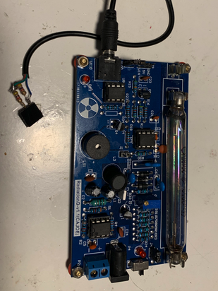

for the Geiger counter sensor:
The output is 1.0V to 4.8V. Also for the GND, V+5, Vin. But the Vin pin is a high impedance output, not usable wit the RPI.
See pictures how to setup.
1. use audio cable, cut and add 2 resistors as voltage dividers, the blue cable was ground with mine, but you need to test.
Screen Shot 2019-08-23 at 19.20.19.png (323.58 KiB) Viewed 5172 times
2. bridge P100 connectors - next to headset output. That enables the audio output.
Screen Shot 2019-08-23 at 19.17.04.png (244.31 KiB) Viewed 5172 times

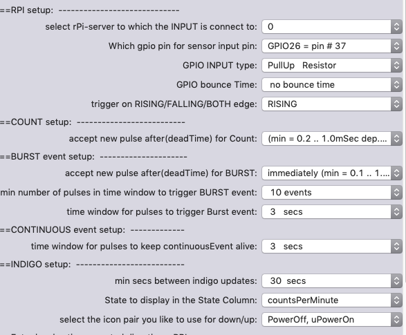

setup in indigo:
Screen Shot 2019-08-23 at 19.22.59.png (92.08 KiB) Viewed 5172 times

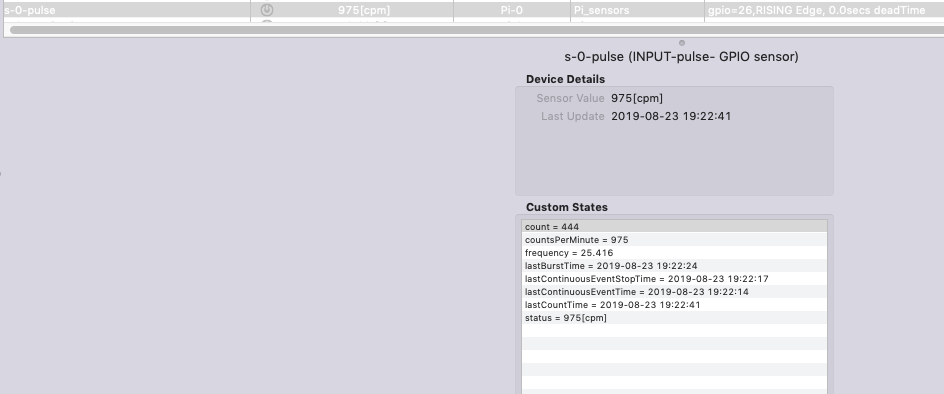

and device view:
Screen Shot 2019-08-23 at 19.22.44.png (43.21 KiB) Viewed 5172 times
