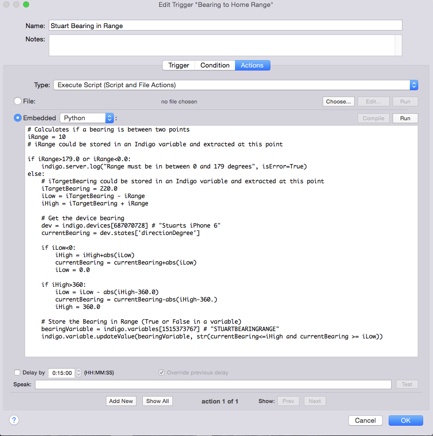

I've been playing with the "Bearing to Home" feature as a condition. In order to determine if i'm on my way home, can i use .... if "Bearing to Home" is between -30 & 30? It doesn't seem to work. I tried NW to NE, but the non-numerical values are not accepted either.
Chameleon
Posts: 611
Re: Hotfix version 1.0.37 - calculation update
Post by Chameleon »
nev wrote:I've been playing with the "Bearing to Home" feature as a condition. In order to determine if i'm on my way home, can i use .... if "Bearing to Home" is between -30 & 30? It doesn't seem to work. I tried NW to NE, but the non-numerical values are not accepted either.
Nev
The Bearing to Home is a calculated field with a value of 0-359.99 (as 0 degrees is also 360 degrees) so it's never negative. I know what you want to do but the number is telling you the bearing to home not a range. I could add the feature in the next release later this week.
In the meantime - you could have a trigger that happens whenever there's a change in the Bearing to Home for a device. That trigger would then have some embedded python code that determined if it was in the range you had in mind and, if it was, it would alter a variable flag from false to true.

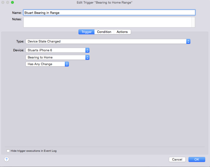

For example - I want to check a phone called Stuart iPhone 6
I create a trigger for the iDevice (in this case Stuarts iPhone 6):
Bearing Trigger
Bearing Trigger
Screen Shot 2015-10-07 at 15.00.07.png (54.93 KiB) Viewed 4103 times
Notice I've used the Bearing to Home as a trigger.
The condition I leave blank but obviously you could add other conditions here...
Now I create a Server action using Execute Script and put the following code in the embedded python box
Calculate range for bearing...
Screen Shot 2015-10-07 at 15.07.58.png (140.82 KiB) Viewed 4103 times
Here is the code for pasting...
# Calculates if a bearing is between two points
iRange = 10
# iRange could be stored in an Indigo variable and extracted at this point
if iRange>179.0 or iRange<0.0:
	indigo.server.log("Range must be in between 0 and 179 degrees", isError=True)
	# iTargetBearing could be stored in an Indigo variable and extracted at this point
	iTargetBearing = 220.0
	iLow = iTargetBearing - iRange
	iHigh = iTargetBearing + iRange
	# Get the device bearing
	dev = indigo.devices[687070728] # "Stuarts iPhone 6"
	currentBearing = dev.states['directionDegree']
	if iLow<0:
		iHigh = iHigh+abs(iLow)
		currentBearing = currentBearing+abs(iLow)
		iLow = 0.0
	if iHigh>360:
		iLow = iLow - abs(iHigh-360.0)
		currentBearing = currentBearing-abs(iHigh-360.)
		iHigh = 360.0
	# Store the Bearing in Range (True or False in a variable)
	bearingVariable = indigo.variables[1515373767] # "STUARTBEARINGRANGE"
	indigo.variable.updateValue(bearingVariable, str(currentBearing<=iHigh and currentBearing >= iLow))
This code can be edited to suit or you can use indigo variables to state the +/- range and the target bearing. I know the code looks a little complicated but it ensures that regardless of the bearing and target values it returns the correct answer. Finally, based on the result of the calculation it sets an indigo variable (STUARTBEARINGRANGE) to true or false. That could be used to trigger other events.
I'll look into including the feature in iFindStuff but this method does work :D
Regards
Mike
Thanks Mike! I'll try it out!
