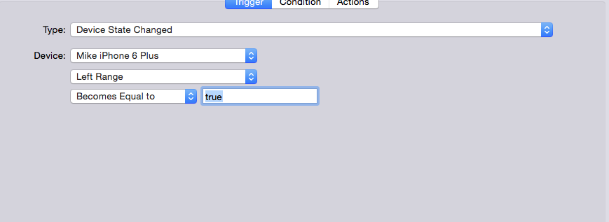

I'd use the deviceLeft and deviceEntered logic flags to see if a device has left or entered a GeoFence and then Check the Left Name for the Geo it's left.
For example:
This is a trigger that will notice when I leave a GeoFence...
Screen Shot 2015-09-20 at 19.17.10.png (28.58 KiB) Viewed 6083 times

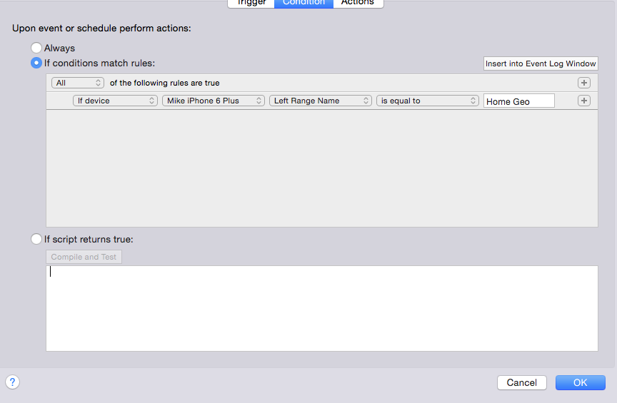

Then I've attached a Condition to make it even more specific:
Screen Shot 2015-09-20 at 19.16.52.png (48.01 KiB) Viewed 6083 times
So this trigger will notice when I leave a GeoFence and that Fence must be the Home GeoFence :D

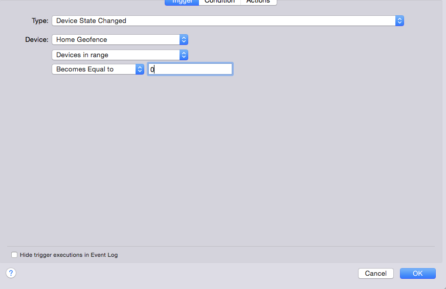

If you want to check that everyone has left a GeoFence you can check the GeoFence Device:
Screen Shot 2015-09-20 at 19.21.27.png (39.8 KiB) Viewed 6083 times
That's probably the easier option in some cases :mrgreen:
