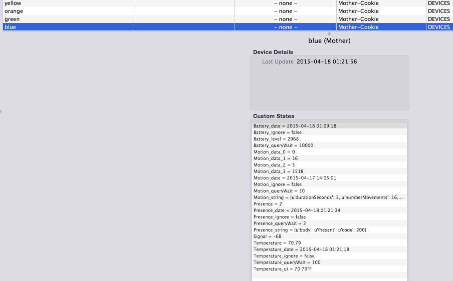

and populate states in the indigo devices:
Screen Shot 2015-04-18 at 1.22.00 AM.png (84.58 KiB) Viewed 16338 times

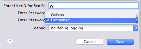

In the general Config you can/must enter YOUR Sen.se userid and password, if you like to use Celsius or Fahrenheit for temperatures and set the debug level.
Screen Shot 2015-04-18 at 2.00.41 AM.png (29.23 KiB) Viewed 16334 times

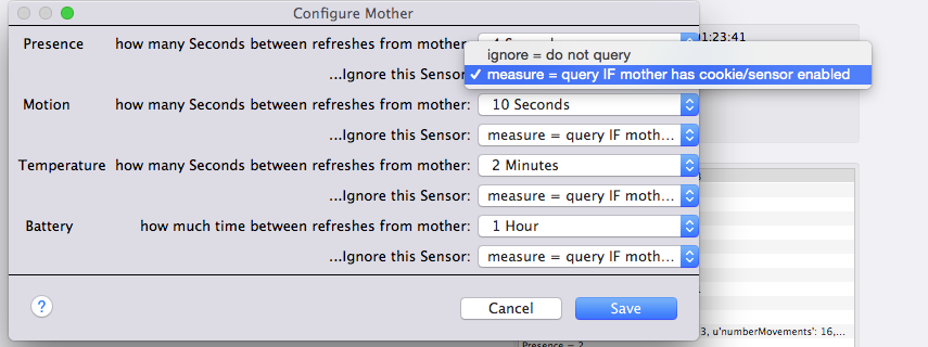

In edit device in indigo you can set for each sensor in each cookie:
- query timing i.e. how often should the sen.se websever be queried. Please be aware that there is a limit of 100 queries per minute. So don't put everything to the lowest number.
- ignore/ measure the value = activate the queries and populate the data to the indigo device states. if ignore no very is send to sen.se and no data is populated in indigo
please be aware that you ALSO have to enable the "apps" on the sen.se web server.

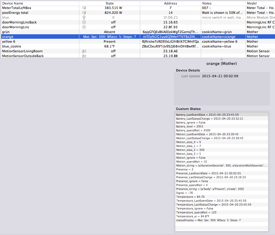

+ added support for enable / disable device.. i.e. if disabled no queries are send to SEN.SE and data stays static.
Screen Shot 2015-04-21 at 12.02.26 AM.png (164.12 KiB) Viewed 16182 times

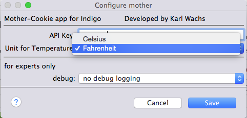

3. only API key is needed, no userid / password any more .. enter in config

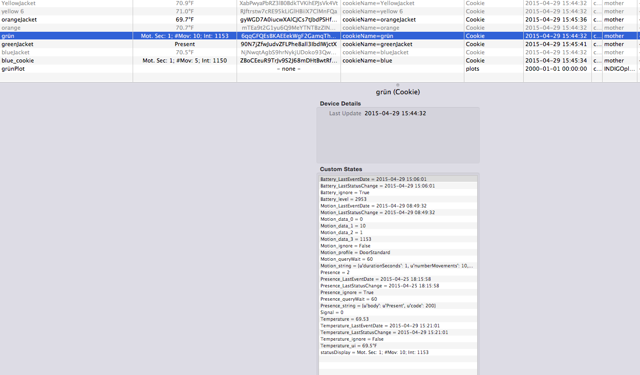

Screen Shot 2015-04-29 at 3.44.28 PM.png (35.8 KiB) Viewed 16119 times

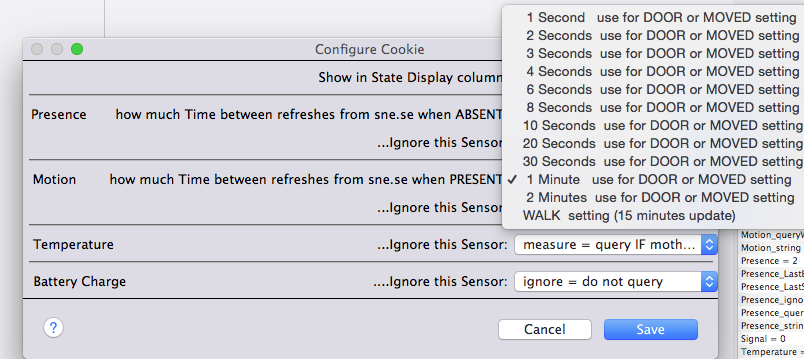

5. added functionality to support the 3 different modes for "Motion":
- Bed: update every 3 minutes
- Door/Moved: update as soon as movement
- Walk : updated every 15 minutes with summary of walk stats
For door, moved and bed you can set the response time i.e. how often query should be performed. For "Walk" it is fixed , set to 15 minutes
Screen Shot 2015-04-29 at 3.45.52 PM.png (139.76 KiB) Viewed 16119 times
6. when "absent" all queries to sensors but "presence" will stop. You can select the frequency how often the plugin should check if the cookie is back home. Once back home all other sensor in the cookie will go back to normal query mode.
The available state information is shown here, each can be used as a trigger
Screen Shot 2015-04-29 at 3.46.15 PM.png (179.7 KiB) Viewed 16119 times

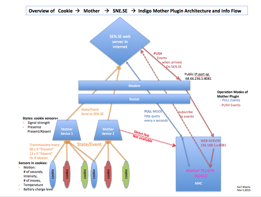

NEW this plugin now has 2 different modes to get the cookie data into the plugin
1. PULL as previously described
2. PUSH: The mother SEN.SE web server will push new events / information to a web server on your MAC. This plugin will setup almost everything you need to do. It knows your public internet IP number and the IP number of your MAC .The only thing you need to do is to enable the proper port on your router and set it in the config menu
The setup is actually easier than in the pull mode. The plugin does not have to guess when new data is there, but it will arrive in the plugin initiated by the SEN.SE web server.
In the PULL version one has to setup timing parameters etc. All that goes away in the PUSH version.
This will reduce the WEB traffic by a factor of 10 and improve the response time to 2-3 seconds after e.g. a motion has occurred in one of the cookies.
You can switch between the 2 modes in the configuration menu. The menus adapt to the mode i.e. present only those parameters needed to be entered for the selected mode.
The attached shows the architecture and flow of the data.
Screen Shot 2015-07-20 at 10.47.21 PM.png (196 KiB) Viewed 15856 times
The web server used is the webserver that comes with python. It is a simple HTTP server, NOT HTTPS. In order to do that you would need to register your site and add certificate files etc. The web server could support this.. may be next version.
The web server will only accept data with proper contents i.e. a specific key word from SEN.SE must be present.
If it receives any other data it will shutdown and restart . That takes ~ 1 second.
If you want to look at the incoming traffic it creates a log file in the ~/documents/mother/ directory including timestamp and source IP number
In summary:
This new version delivers response times of ~ 2-3 seconds of events from a cookie to INDIGO. It exposes all sensors and information available from the cookies/mothers as states in the plugin. You can set triggers on temperature, motions, and presence.
With this setup it actually can be used nicely for a presence/absent or home/away trigger with reasonable response time. When AWAY the cookies seem to send pings to MOTHER every 12 seconds. If you position one of your MOTHERS near to the entrance it will have enough time to react and open doors automatically before you reach the door.
A direct link between the INDIGO plugin and the MOTHER devices is not available, may be in the future.

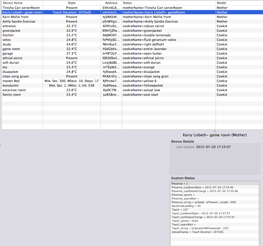

1. added mother itself as a device. You can see status for "Present" and "Touch" (When you touch the eyes it sends a message on length of the touch event)
2. added state for cookies "mother associated to cookie". You can see where the cookie is located closer too. That works in 80% of the cases as each cookie associates to the first mother it finds after it looses its connection. That might not be the nearest.
3. you now can rename the Mothers and Cookies on SEN.SE and the name changes gets reflected in the notes filed as "name of Cookie=xxx"after some seconds.
4. added state that shows the # of seconds since the last message from/ about the cookie/mother has been received.
all these work for both modes: push and pull

the ~/documents/mother/motherwebserver.log was not reset when size > 5MByte, now the log file gets renamed to ....-1.log and a new log file gets started if the file gets bigger than 5MB.
Screen Shot 2015-07-20 at 5.53.12 PM.png (174.46 KiB) Viewed 15874 times
