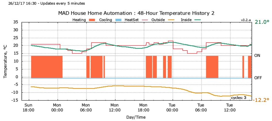

I have noticed a similar failure of the plugin to respond in real time to on off state changes of the heater or air conditioner controlled by my Nest thermostat. In my case, I’m computing the total HVAC running time, and by inference, the cost of power required to heat or cool my house. When the heating or cooling turns on Indigo grabs and saves the current time (turn_on_time in seconds) and when heating or cooling subsequently turns off Indigo subtracts the turn_on_time from the new current time to get the running time. The resulting value is logged, analyzed and plotted.
So, big problems in the data set occur if the plugin misses the turn_on or turn_off events from the Nest. I’ve added code to my analysis routines to ignore data sets where either a turn_on or turn_off time is missing. But, I sometimes have to go into the log files and adjust the data to fix any problems that occur when the times are present, but much longer than I think they should be. (I can only guess what the actual times are, but obviously the plugin failed to see a turn_off event in real time when my heater is apparently still running after 5-6 hours—it’s rarely that cold here!) This type of error occurs once or twice every couple of months.
I don’t know why the plugin misses these events, but this is a general problem for real time communications between asynchronous systems. There are better solutions to ensure higher reliability such as MQTT with its Quality of Service levels. Perhaps Mike’s plugin could take advantage of MQTT, but I don’t know the technical details and cannot say how much effort this would require for our benefit.
Here’s an example of how I use the data I get from the Nest plugin. I’d say something went wrong between Sun 18:00 to Mon 00:00 because the furnace is apparently on, but the Inside temperature has continued to fall. In fact, the Nest was in Away mode at that time, so the heater was most probably off—an example of a missed or delayed turn_off event.

- heating_graph.jpg (92.02 KiB) Viewed 2296 times

Yes, having this visual record has improved my insight into how my system works. For example, I can set the temperature back enough at night to earn a Nest Leaf knowing that the house will never cool down that low.dduff617 wrote:I appreciate the input, MikeL. Good to know it is apparently not something specific to my system/devices.
Also, I will take inspiration from your plot to setup my own so I can keep a closer eye on my system going forward.
