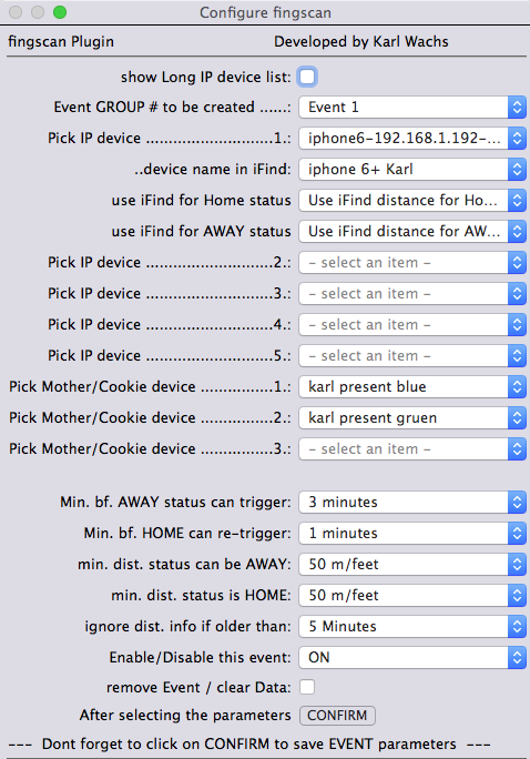

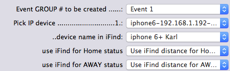

1. in iFind in Menu/Plugin/iFind/Configure enable the FINGscan link checkbox
2. in FINGscan select iFind like in the attached screen shot: The cool part in this that it minimizes queries between the plugins by using the “tickle” trick. It is like a trigger, but the user does not have to set anything up and adopts automatically to changes in parameters.
Thanks to Mike for reviving the iFind/iDevice functionality (We missed that for a long time!!) and for implementing the tickler.
if anyone is interested in how this work, let me know... or you can check the iFind and FINGscan plugins yourself

How to enable:

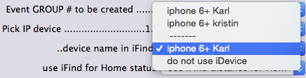

fixed:
menue was not properly populated, settings was saved though.
now the ifind device selection is shown as follows:
below the --- line are
- "previous selection" and above are all options (including the previously selected)
- "remove the device" option

fixed:
