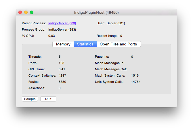

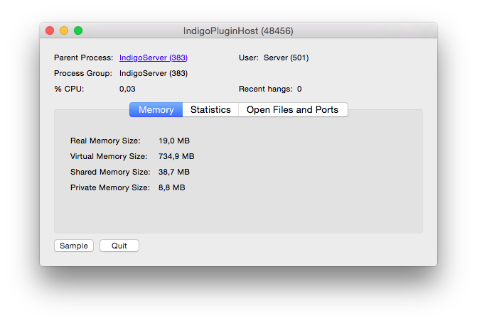

ps do you see any load from the program in activity log? should be minimal.
haavarda
Posts: 702
Location: Norway
Re: Python script for thinkingcleaner roomba interface
Post by haavarda »
Yepp that is indeed minimal... See the pictures below:
Screen Shot 2016-02-06 at 18.24.57.png (65.93 KiB) Viewed 6459 times
Screen Shot 2016-02-06 at 18.24.38.png (58.96 KiB) Viewed 6459 times
