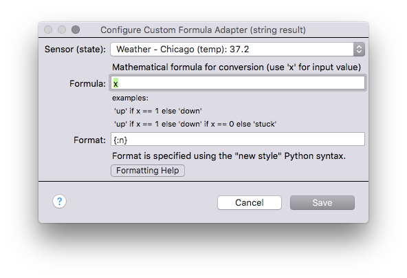

Actually, the Adapters Plugin sounds like a superior option. I can't easily test this, but after reading the docs, I *believe* that this setup *should* yield the string '37,2'.
Screen Shot 2017-01-25 at 8.50.02 PM.png (59.76 KiB) Viewed 7389 times
Will need to rely on someone with a proper locale setting to test it out, however.

I did a quick test, and it returns the decimal number, but with period: 37.2 :?
I'm guessing the locale has to be set within the plugin, but again don't know if this would mess up other things in Indigo or the plugin..
