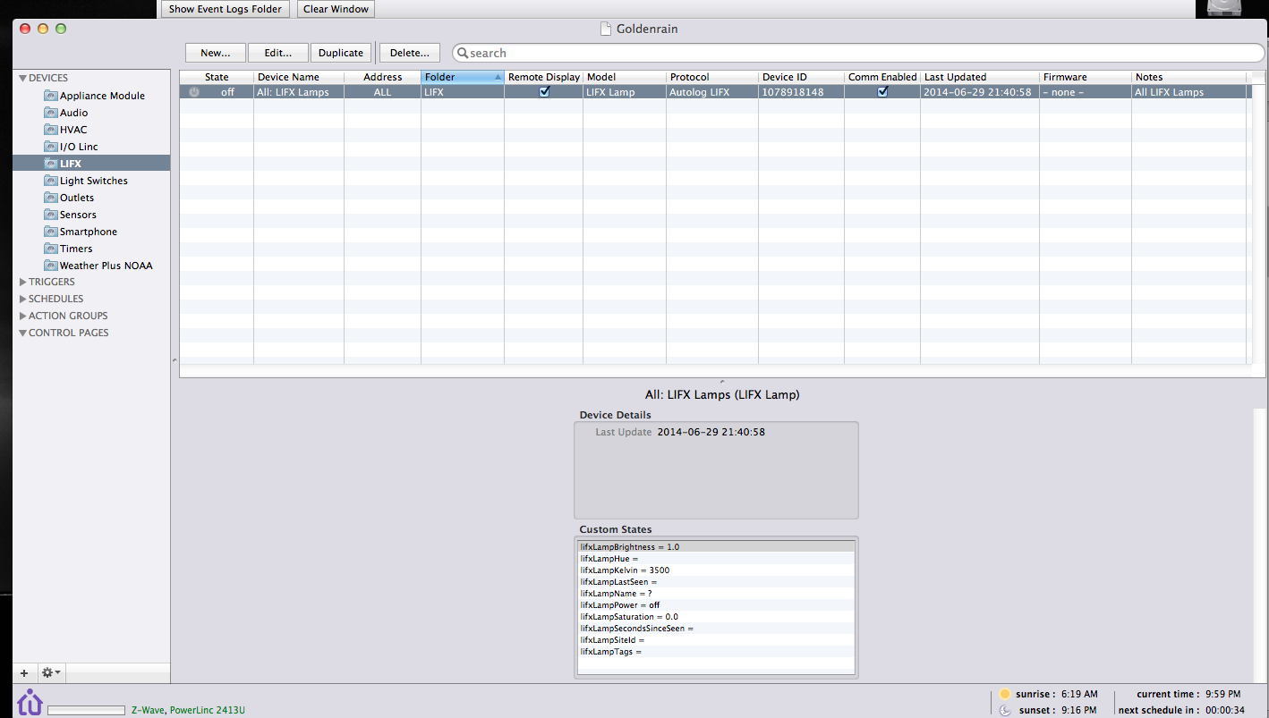

Thanks for getting this plugin up and going. I have installed the plugin but it does not show my bulbs (I have 2) individually, I just see "all bulbs". Also I'm not able to control the bulbs with triggers or action groups.
I have reloaded the plugin
I have reset both Lifx bulbs
Jun 29, 2014, 9:40:56 PM
Enabling plugin "Autolog LIFX 0.1.0"
Starting plugin "Autolog LIFX 0.1.0" (pid 5283)
Started plugin "Autolog LIFX 0.1.0"
Autolog LIFX Autolog 'LIFX Controller' initializing
Autolog LIFX Initialising LIFX Command thread for 127.0.0.1:56780 [lifx-http]
Autolog LIFX LIFX Command thread initialised for 127.0.0.1:56780 [lifx-http]
Autolog LIFX Started 'All: LIFX Lamps': 'ALL'
Again thanks for your work on getting this plugin developed and sharing it with everyone.
This is my device view, note that it says they are off, but they are not
Screen Shot 2014-06-29 at 9.59.21 PM.png (131.53 KiB) Viewed 11299 times
Larry

For some reason it isn't detecting any of your lamps. The 'All: LIFX lamps' gets added in by default assuming that lamps will be found - I will maybe need to change how this works in a future version to avoid confusion. Also the custom states for 'All: LIFX lamps' and 'Group: ...' lamps don't mean anything - I will alter this as well.
I will have to enhance the error reporting and debugging to determine what is going on.
As an initial step, can you check that lifx-http is working correctly as detailed in the LIFX-HTTP API web-page.
I suggest the following steps:
  1. Disable my plugin
  2. Open a terminal window and enter 'lifx-http' - the server should start
  3. Open another terminal window and enter 'curl http://127.0.0.1:56780/lights.json' - your lights should be listed
If you can post back the results of the curl command then I can see if it highlights anything.
In the meanwhile I will improve the error checking - this may take a few days :)

I found the problem - I had temporarily disabled the call to the LIFX-HTTP server :oops:
This meant it would never work on another system with a fresh install. It worked on mine because I had the LIFX-HTTP running in a terminal window as I was debugging some code.
Hopefully it will work now :)
