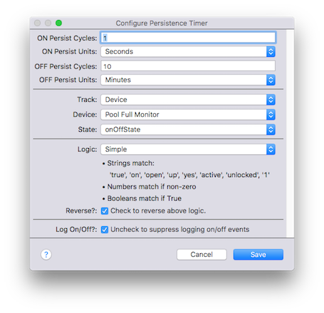

I have a question on the operation of a Persistence Timer. This is being used to track a switch that is closed when the water in a swimming pool is below a certain level, and open when the water is above that level (i.e. "full"). Here is the device configuration:
Device Settings...
Device Settings...
Screen Shot 2017-08-19 at 08.29.05.png (102.06 KiB) Viewed 14663 times
I would expect this to set itself to On any time the monitored switch goes Off, and to set itself to Off after 10 On observations, at 1 minute intervals, from the switch.
In general, it seems to do that. However, I also see the following every 10 minutes (assuming the pool is full)
  • 19 Aug 2017, 05:25:10
    Timed Devices "Pool Full State" off
    Timed Devices "Pool Full State" on
    19 Aug 2017, 05:35:13
    19 Aug 2017, 05:45:16
    19 Aug 2017, 05:55:18
    19 Aug 2017, 06:05:21
Since I have checked the box to not suppress logging of on/off events, I would assume I should see a log entry overtime the state changes, not every 10 minutes when the timer expires but the state hasn't changed.
Is this the way the plugin should operete> Or, Am I misunderstanding something?
And, BTW, thanks again for a quite useful plugin.

Haven't you got your On Persist and Off Persist the wrong way round? (Not the inputs - which you've correctly reversed)
Are you wanting this timer to go On when the pool is fully-full?
So lapping water as it gets nearly full won't turn it on, but water when it's stayed full for 10 minutes will do?
If so, set On Persist to 10 minutes, and Off Persist for some value (how many seconds of constant "not full" readings from switch before the timer goes off, ie says the pool really isn't full rather than someone dive bombing in it).

berkinet wrote:I would expect this to set itself to On any time the monitored switch goes Off, and to set itself to Off after 10 On observations, at 1 minute intervals, from the switch.
Not quite. With your configuration, the plugin device will turn On after the monitored switch has been Off for one second, and turn Off after the switch has remained On for 10 full minutes. Every time the monitored switch changes state, the plugin notices and cancels or restarts the timers (i.e. there is no 'sampling'). If this is not the behavior you want maybe you could describe your intent in a little more detail.
All that said, I still don't understand why you are getting those log entries.
berkinet wrote:I would assume I should see a log entry overtime the state changes, not every 10 minutes when the timer expires but the state hasn't changed.
Could you elaborate? Are you saying the monitored switch state hasn't changed, the plugin device state hasn't changed, or both? If the monitored switch is changing, it would be helpful to see those changes in context with the plugin device log.
I have made the debug logging a bit more helpful and released an update. If you're still having issues, you can update the plugin and post the debug log.
