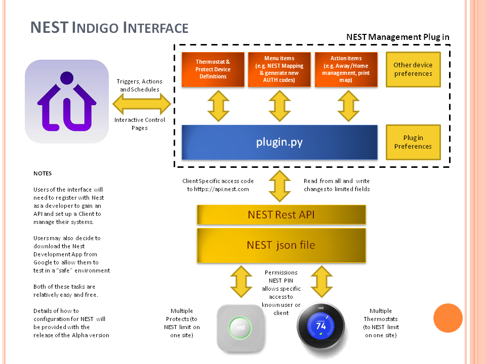

Just a quick diagram attached of what we're going to be testing. If you want to start by preparing the developer ID and getting NEST Development App. You'll find that this page gives you all the information you need to prepare (https://developer.nest.com/documentati ... uick-guide). Specifically you're aiming to get a unique authorisation key for your test set up. I'd advise you to start with a 'virtual' set up that matches yours because you can test with causing any other issues
One additional field that I missed is fan_timer_active which has write access. Not sure if this means you can switch on the fan but it will be worth testing.
