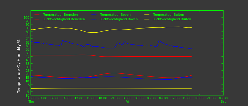

I think I have the same problem Karl. This morning we were punished with an outside temp of -4,5 degrees, but the (yellow) line is constant flat.
Left AND Right Scale are 00:110
Both Tick marks are; -10,-5,0,5,10,15,20,25,30,35,40,45,50,55,60,65,70,75,80,85,90,95,100
Version 3.7.27
Kind regards,
John
Version 3.7.27
Kind regards,
John
- PlotTemp+Temperature-Humidity-minute-S1.png (36.46 KiB) Viewed 5361 times

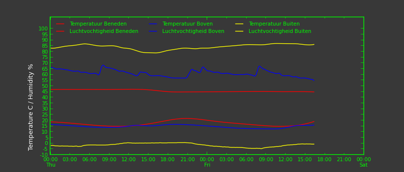

Re: INDIGOplotD -- a plot tool for indigo
John,
when he Y range is set to 0:110 then there can not be anything below 0.
are you sure about the YRange?
please try YRange:-10:110
Sorry, my fault
Range set to -10:110
Solved! Thanks for the fast answer.
John
John
- PlotTemp+Temperature-Humidity-minute-S1.png (38.93 KiB) Viewed 5355 times

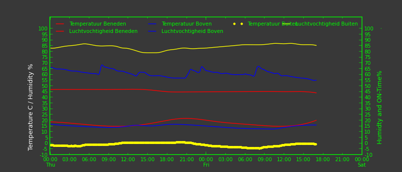

John,
you should try the scatter plot for temp& humidity.
The Temp curves are hardly changing.. with these settings..
ps .. right now yo can have only ONE scatter line per plot

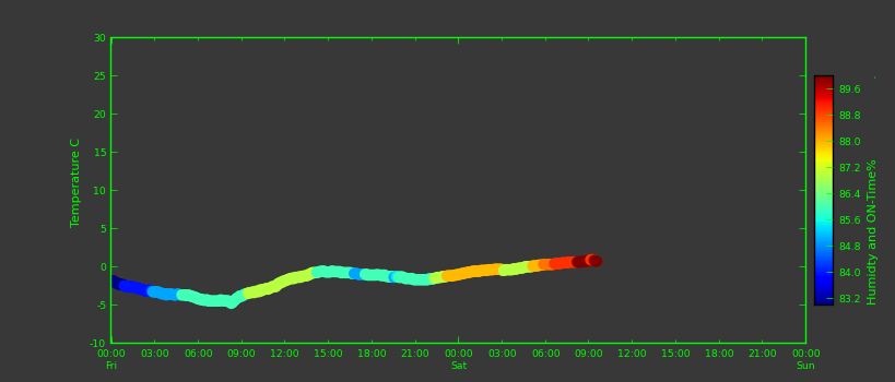

Funny to play with
- PlotTemp1+Temperature-Humidity-minute-S1.png (41.65 KiB) Viewed 5353 times
John,
try this: setup a new plot
expert ON
Yrange: -10:30
dataA= temp
func= the last one ... value as color of dot
dataB= humidity
linewidth=3
nothing else.
expert ON
Yrange: -10:30
dataA= temp
dataB= humidity
linewidth=3
nothing else.
