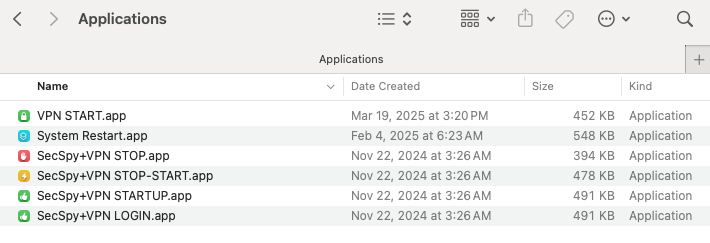

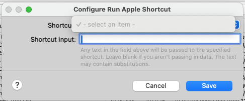

All of these actions calling Apple Shortcuts were working, however now there are no shortcuts available to Indigo in the drop down menu to select them. They run perfectly from the dock and the menu bar
This should be a no brainer! Any ideas on what I may have done and how to fix this to get them accessible and working again from Indigo? They have been working for some time!

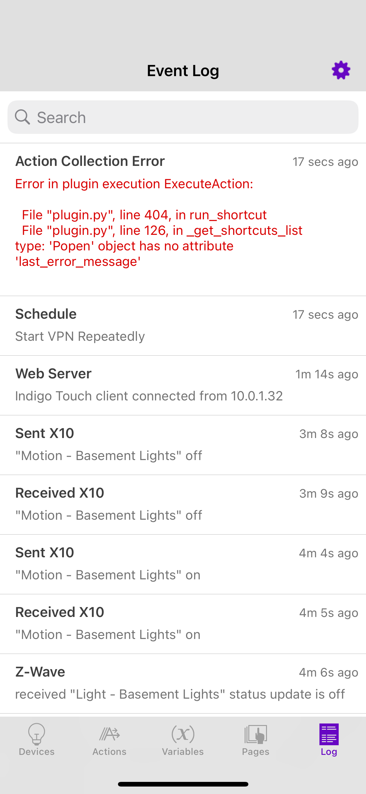

I noticed this in the logs on my phone...

Started plugin "Action Collection 2024.2.1"
Action Collection Error Failed to get the shortcuts list due to a macOS system error. Please report the following error to Support. Disabling shortcuts.
Action Collection Error Command to get the shortcuts list failed with error '-9'

I'm using Server Actions->Run Apple Shortcut action but no shortcuts are showing up now for some reason. Again it was working, not sure what I did or mysteriously happened. Or when it stopped. I think it was working under 2024.1.0, it seems like I was able to run actions calling shortcuts as early as last week.
