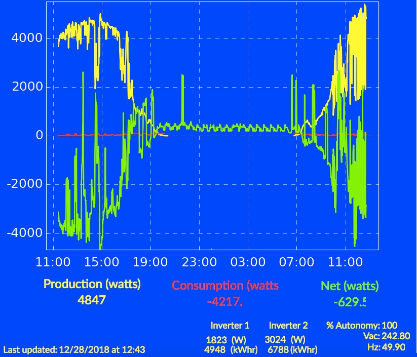

I have recently installed a 6kW system, and after investigation settled on 2 x 3kW Fronius inverters. Happy with the result and in particular the Fronius "solarweb" interface.
Fronius have published their API and I have managed to import data into Indigo for display on a control page - but a plug in is beyond my limited time availability - not to mention my even more limited coding skills
Having had this data visible has proved useful, as it identified an over-voltage issue on the grid, that was sending the inverters into power limiting mode and in extreme cases shutdown of export to the grid. This is regularly (almost daily) limiting the energy exported to the grid and the financial benefits of the associated feed-in tariff. The supply authority has acknowledged the issue and is in the process of rectifying it.

Fronius have published their API and I have managed to import data into Indigo for display on a control page - but a plug in is beyond my limited time availability - not to mention my even more limited coding skills![]()

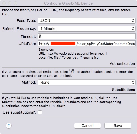

Thanks for your enquiry!
Initially I had written some (very!) basic scripts to access the Fronius data and store in variables.
However, I subsequently discovered the excellent Ghost XML plug in, and am using that with great success as the Fronius responses are in JASON format
Depending what data you are seeking, depends on which Ghost XML device to create. I have two Fronius 3 kW inverters, together with a Fronius Meter that records the production of the two inverters, and sit consumption. To meet my needs, I have created four different Ghost XML devices in accordance with the plugin's documentation.
These devices are (where XXX.XXX.XXX.XXX is the IP address of your inverter):
Fronius System using the following URL in the Ghost XML device configuration window:
Fronius Power Flow:
Fronius Meter Data:
I have attached an image of one of the Ghost XML config pages to provide further info.
Each of these devices have custom states that can be used on a control page. I am also using Matplotlib plugin to provide graphical representation of system performance. The attached example displays data that has been obtained from the custom states of the Ghost XML devices.
http://XXX.XXX.XXX.XXX/solar_api/v1/GetInverterRealtimeData.cgi?Scope=SystemCode: Select all
http://XXX.XXX.XXX.XXX/solar_api/v1/GetPowerFlowRealtimeData.fcgiCode: Select all
http://XXX.XXX.XXX.XXX/solar_api/v1/GetMeterRealtimeData.cgi?Scope=SystemEach of these devices have custom states that can be used on a control page. I am also using Matplotlib plugin to provide graphical representation of system performance. The attached example displays data that has been obtained from the custom states of the Ghost XML devices.
