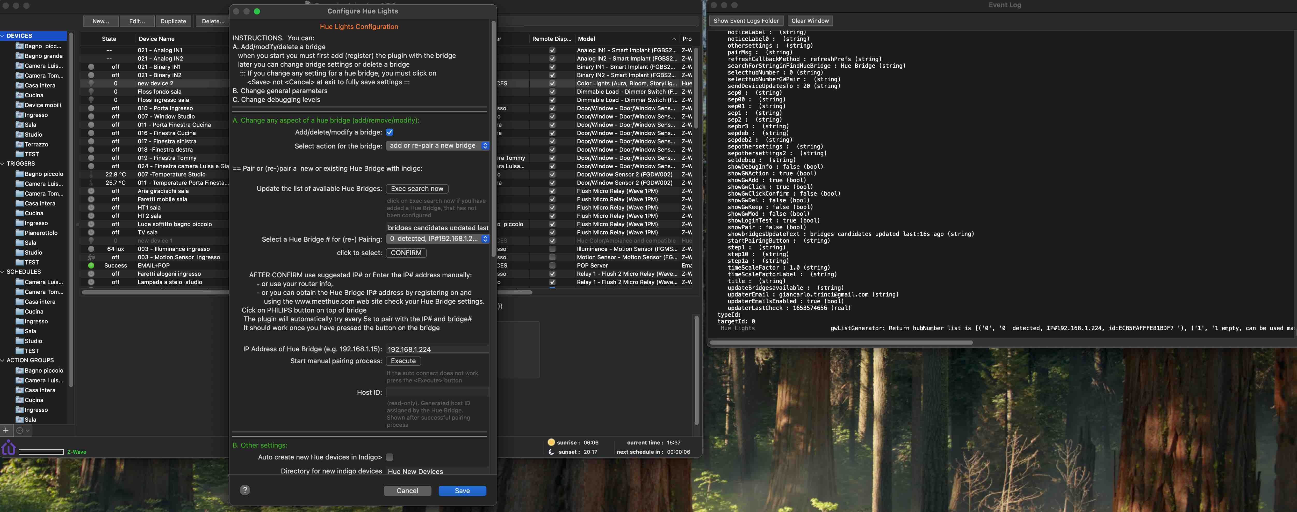

I’m sending you the image of HUB creation (Create HUB)
Create HUB.jpg (451.27 KiB) Viewed 1083 times

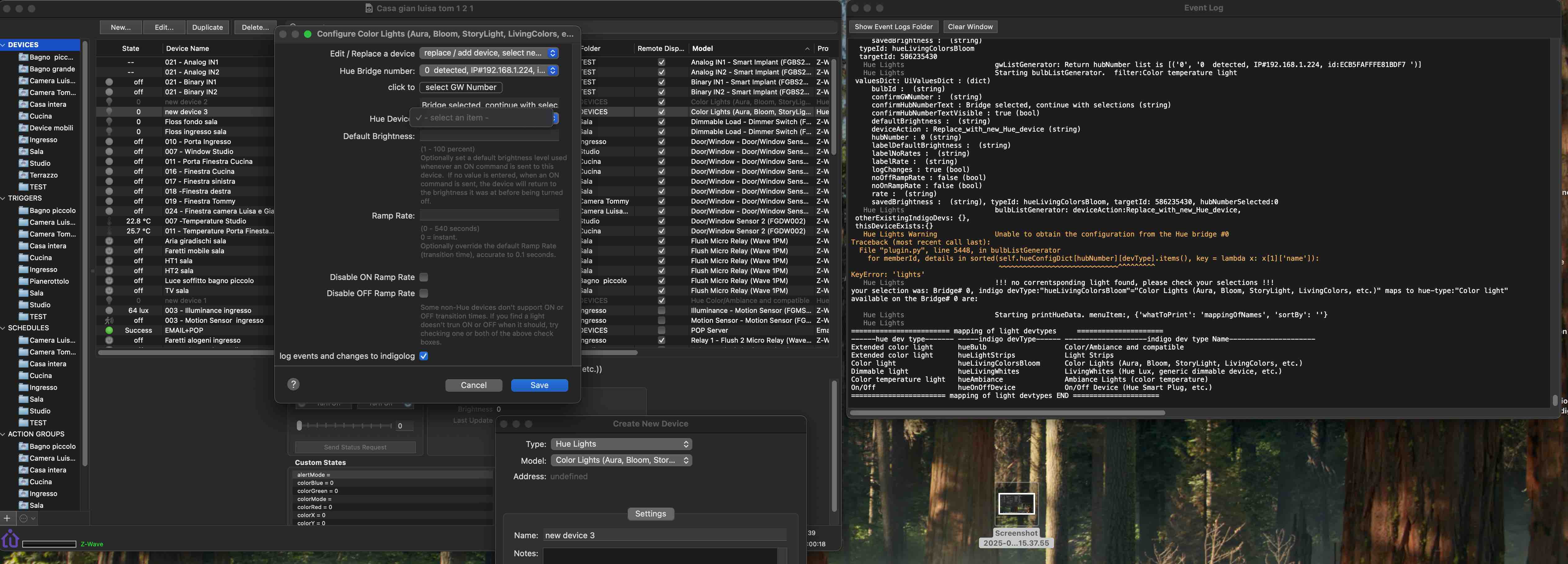

and Device creation (Create device)
Create device.jpg (423.18 KiB) Viewed 1083 times
Anyway, we can talk after May 10th."

Re: Issues with Philips Hue Hub after updating to macOS 15.4.1
Could you restart the plugin. It will then print the recognized and configured hub(s)
