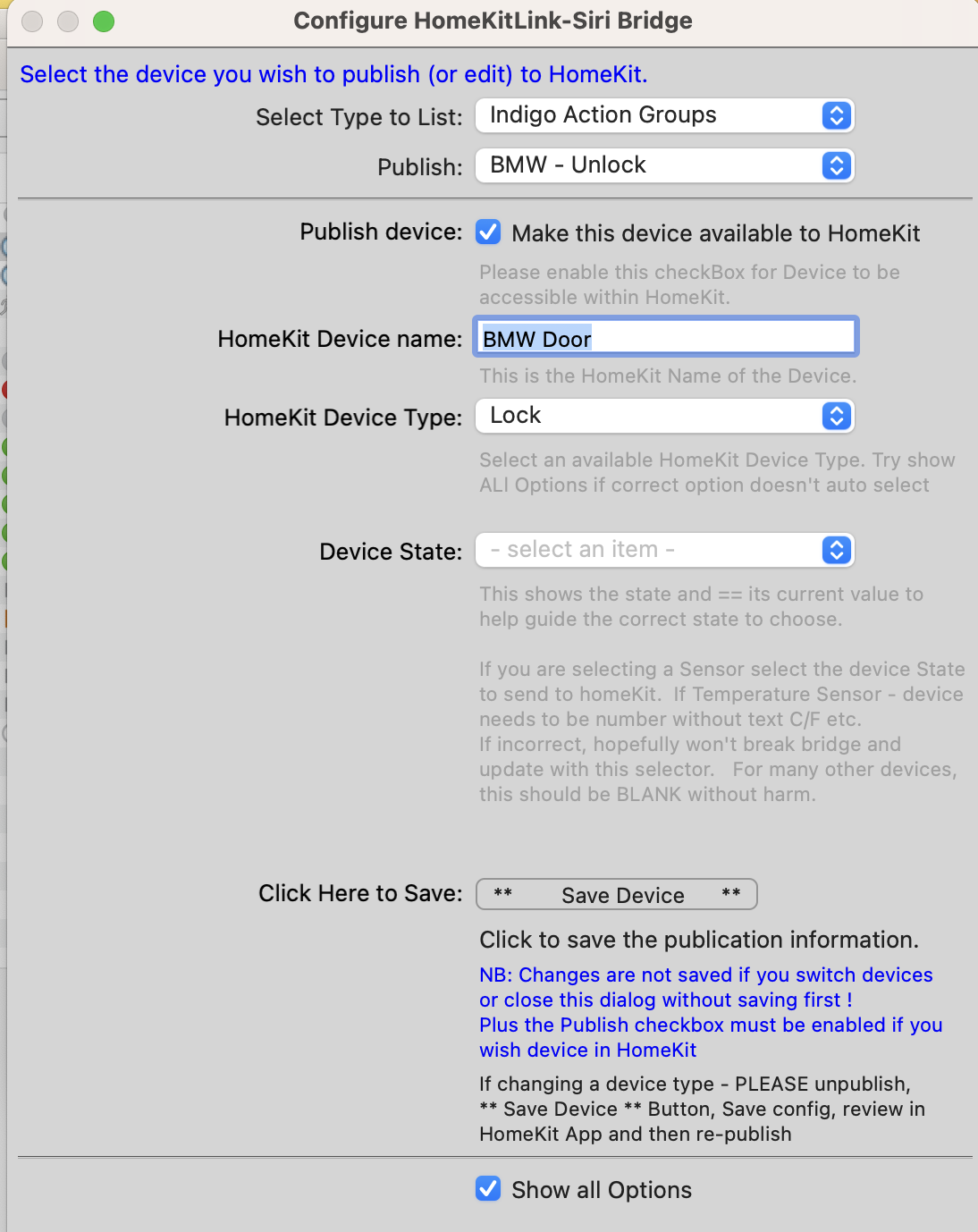

I tried again with the name "BMW Door" , chose Lock type and didn't put anything in the device type. Here's the error I get when I save. The device is created in Home

Here's what happens when I click on the device in Home:
May 27, 2023 at 10:27:54 AM
   HomeKitLink Siri Error          (plugin.py: Function: Plugin_setter_callback  line: 2426):    Exception :  Message : Error in setter callback
   HomeKitLink Siri Error          Traceback:
  File "plugin.py", line 2042, in Plugin_setter_callback
    if "On" in valuetoSet:
   HomeKitLink Siri Error          Error in plugin execution:
TypeError: argument of type 'int' is not iterable
Exc_info: (<class 'TypeError'>, TypeError("argument of type 'int' is not iterable"), <traceback object at 0x11222cb80>)
Exc_Text: Traceback (most recent call last):
Stack_info: None
Here's the configuration of the device in the plugin::
For additional info, the Action Group executes an Unlock command using the Connected Drive plugin

Hi
That will because you are using LockType, having enabled show All Options (which allows any choice)
An Action group - has has no on/off states, or any states at all, it can simply be run or not. It also doesn’t report back any states to Indigo it simply runs, and then we turn back off again.
Instructions:
all action Groups are supported as Switchs/Fans/Outlets only
Follow the instructions to unpublish the device. Unclick the publish button, save device, restart bridge -check gone in the Home app.
Republish it as a Switch type and would guess will work, although you mentioned you have tried as switch? And you first image is as a Switch - perhaps hadn’t been unpublished from Home app before changed?
It is possible to bypass this error for Locks (relates to the complete lack of state). But regardless they still wouldn’t work as Locks needs multiple confirmation of their state. Would sit as Opening…. or Closing… forever…. and not be ideal.
Glenn

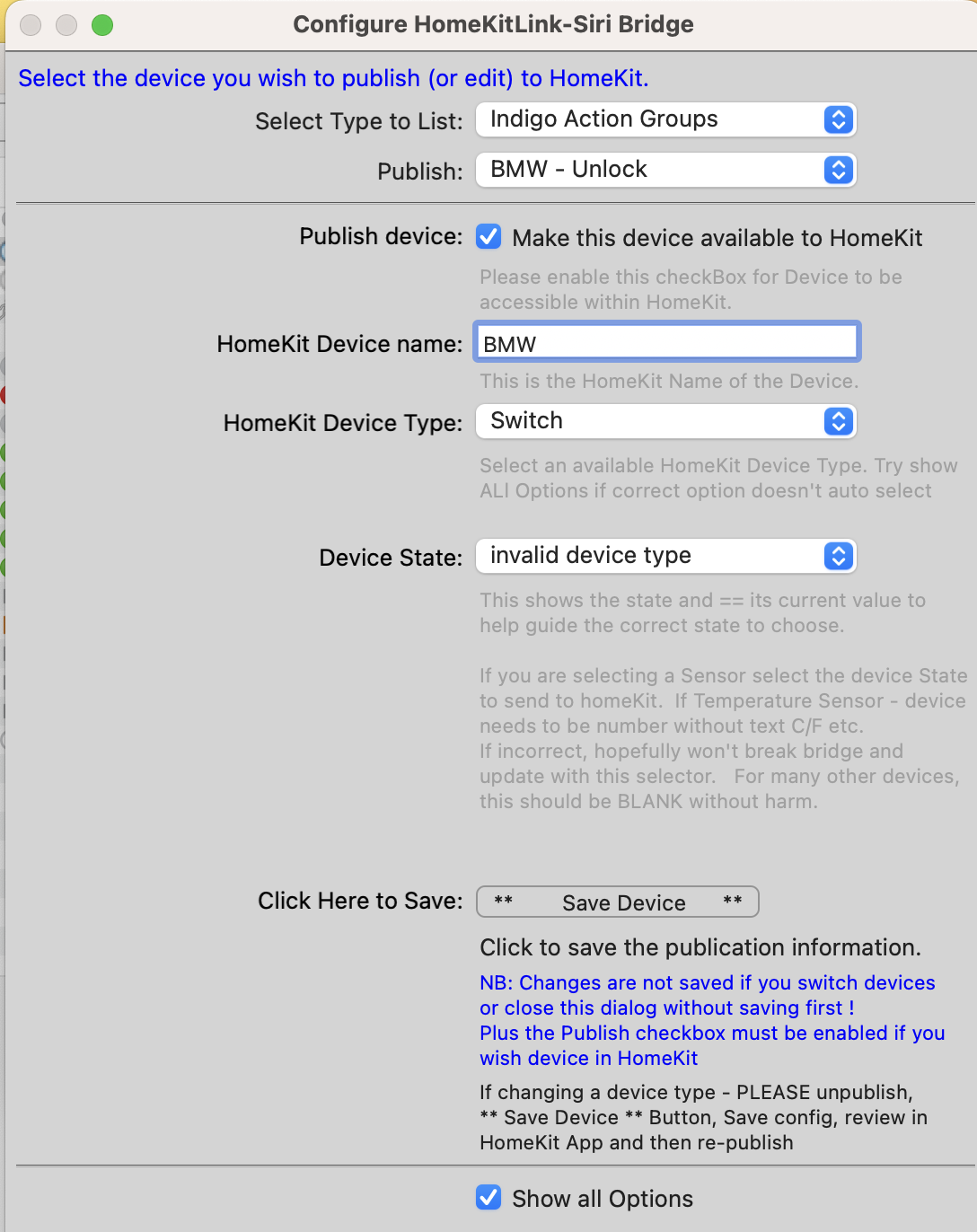

I recreated this using a new virtual device and a switch. It's working now. Thanks

An action group alone still should work - and does on my testing.
Having reacquainted myself with codebase, Just needs to be switch type - as that has the extra logic to deal with the lack of states of action groups.
As a AG Switch - it also acts as a toggle on/off switch. Toggle to on, activating the AG and then immediately returns to Off state.
