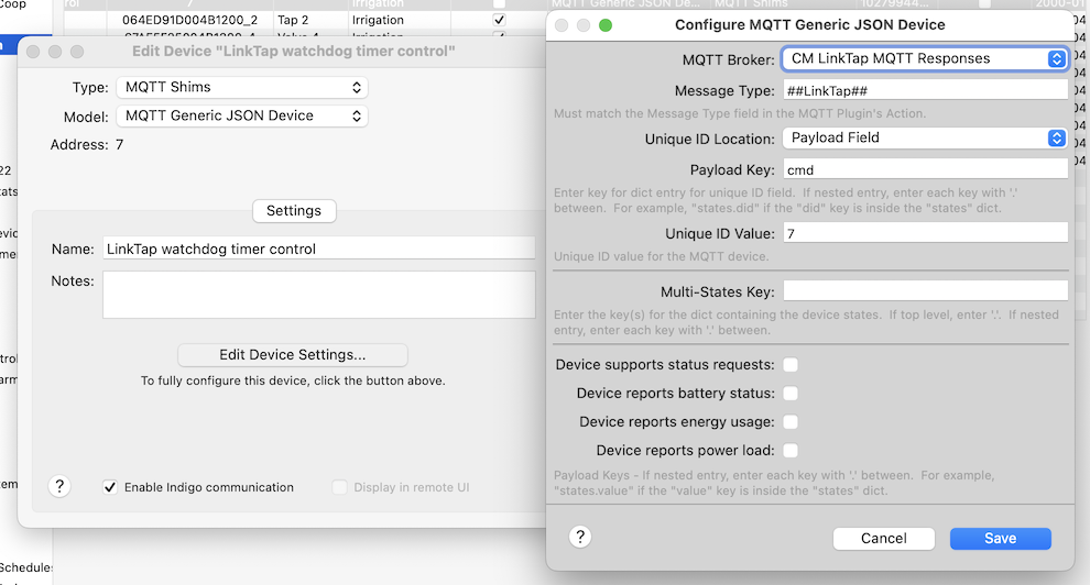

Well, it sounded good. This configuration...
Screenshot 2023-04-01 at 18.35.59.png (197.46 KiB) Viewed 2567 times
Throws this...
   MQTT Received                   cm/LinkTap/up/67AF5F25004B1200_2 {"cmd":3,"gw_id":"5150D91D004B1200","dev_stat":{"dev_id":"67AF5F25004B1200_2","plan_mode":0,"plan_sn":0,"is_rf_linked":true,"is_flm_plugin":true,"is_fall":false,"is_broken":false,"is_cutoff":true,"is_leak":false,"is_clog":false,"signal":72,"battery":100,"child_lock":0,"is_manual_mode":false,"is_watering":true,"is_final":true,"total_duration":3091,"remain_duration":961,"speed":0.00,"volume":161.52,"volume_limit":0.00,"failsafe_duration":0}}
   MQTT Shims Error                Error in plugin execution runConcurrentThread:
  File "plugin.py", line 138, in runConcurrentThread
  File "plugin.py", line 165, in processMessages
  File "plugin.py", line 289, in update
type: 'int' object has no attribute 'strip'
   MQTT Shims Error                plugin runConcurrentThread function returned or failed (will attempt again in 10 seconds)
Re: Triggering on payload contents
That's not going to work. The "Unique ID" for for identifying the specific device sending the MQTT messages, In your case, it's the string "67AF5F25004B1200_2" in the message topic. So you need to change those fields to location = topic, field = 3 (zero based), value = "67AF5F25004B1200_2".
Then put a period "." in the Multi-Key States field, and when you get a message the plugin should populate the "cmd" custom state with the value.
