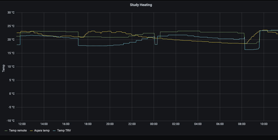

I have an issue with one of mine where the TRV controller is set to use a remote sensor, an Aqara one using MQTT connector. I have that on other ones and all seems ok. But on the study one, where I sit all day, the temperatures on the TRV controller dont seem to update at all.
Screenshot 2020-10-13 at 11.23.54.png (45.09 KiB) Viewed 4877 times
You can see there its showing 23.3 and 23.4 when it should be 23.0 and 19.3

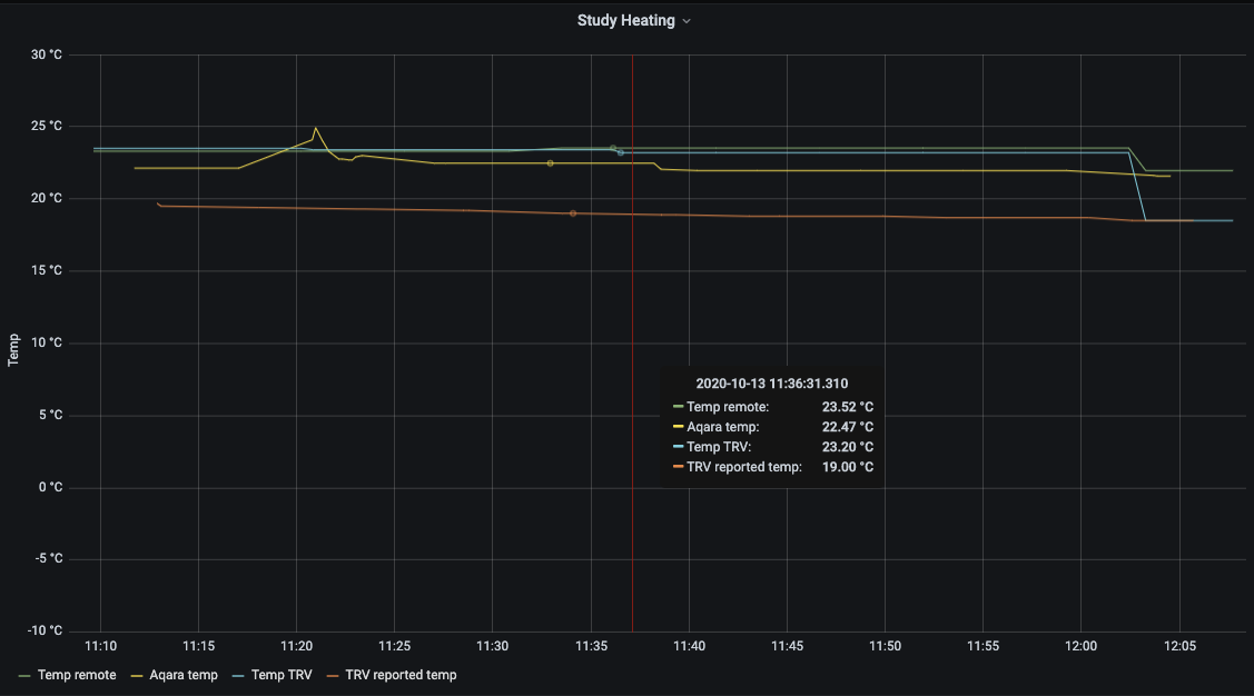

And plotting the remote and trv temperature readings from the trv controller, the remote temperature doesnt track the sensor at all.
Screenshot 2020-10-13 at 11.28.37.png (50.45 KiB) Viewed 4877 times
Any ideas? The jumps when the TRV and Remote temperatures came more in line was when I restarted the plugin. I have 9 TRV controllers running now (which is killing my zwave network when they updated :-) )

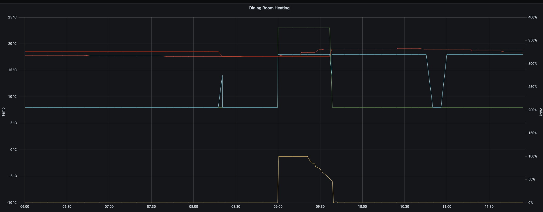

Actually this is happening on all rooms where I use a temperature sensor.
Here the schedule turns on at 9 and set points increase. The TRV one 5 deg higher than the "thermostat" / TRV controller. Thats fine, but you can see the sensor temperature cross the set point at 9:15 ish but no change to the Stat TRV. The TRV itself clearly sees the increasing temperature and starts to close the valve.
The TRV SP is only set to 8 deg, ie turned off, at 9:40ish when the TRV controller temperature suddenly jumps to match that of the sensor. Its set to poll every 5 minutes when schedules are active, but I would think it could be checking the remote temperature constantly, as there is no battery issue like polling the TRV.

This is what happens when I restart the plugin, suddenly the trv controller temperatures come in line, but havent been for an hour (actually more)

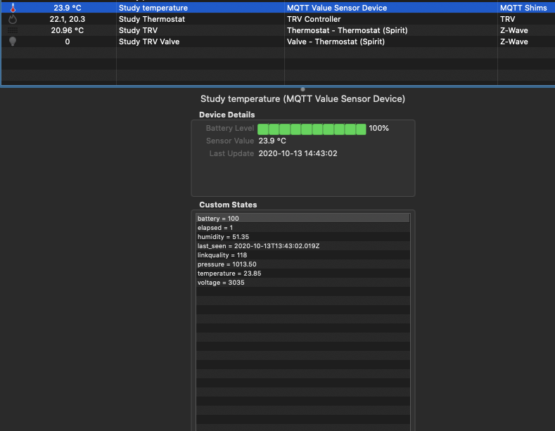

What would be interesting is whether you see that the custom state temperatureRemote on the TRV Controller device actually agrees with the temperature on the Aqara?
I have just checked mine and they do. You need to check once you see the temperature not being updated as you would expect.
siclark
Posts: 2355
Location: UK
Re: TRV controller not updating temperature
Post by siclark »

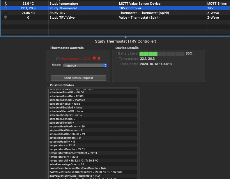

The green line in chart above is the remote reported temperature from the TRV controller. As you see its different.
this is it currently. reporting remote at 22.11 and TRV at 20.3 when the devices are showing 23.9 and 21.5 respectively.

Can you show me the similar image for the Aqara?

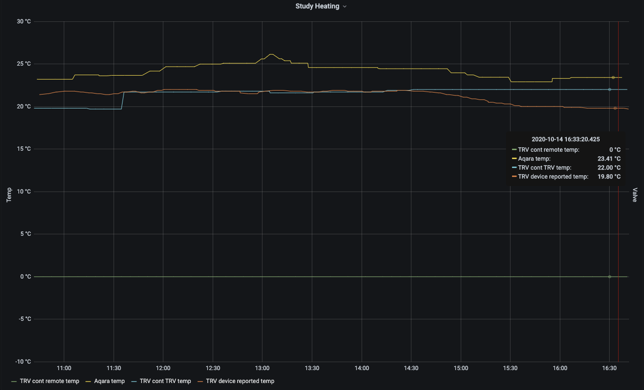

And strangely seeing this on the devices not using a remote sensor.
Screenshot 2020-10-14 at 16.42.43.png (71.41 KiB) Viewed 4727 times
Post by autolog »
The script I PM'd you should pick that up?
It should handle not having an associated Remote. :)
I think the issue we are seeing is that the device updates of the Spirit and Remote (where used) are not always being picked up by the plugin.
Yesterday, I noticed one of my Aqaras was having updates that weren't picked up but is behaving itself today.
I am running the script every 15 minutes and (famous last words), haven't detected an anomaly yet. :)
