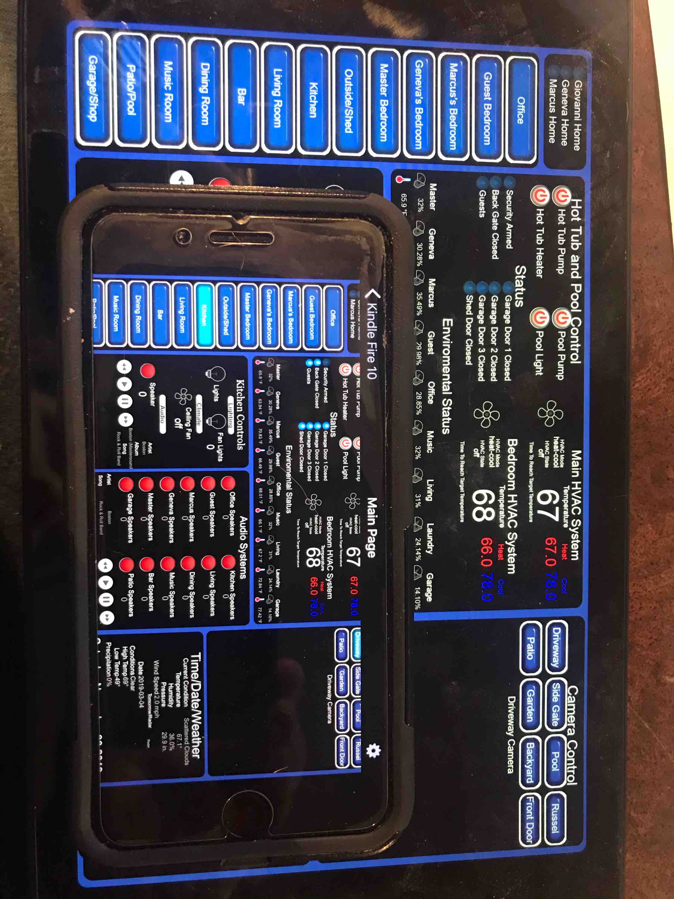

Forgive me if this has been covered, I didn’t really see anything about in the posts. I’m having an issue where my custom images for my buttons on my control pages are not showing the “on” stated. The images work fine in Indigo Touch, but they do not work in domopad. Have I done something wrong or is this expected behavior? When I created the png files the off file was called button.png (for example) and the on image was called button+on.png. Another interesting thing is that the stock indigo control page images work fine. Attached is a screenshot with a 10” tablet running domopad and an iPhone running the same control page in indigo touch so you can see the differences. I would love to hear if anybody else is having this problem, or had this problem and has a solution.
This is likely your main issue -- the base image needs a plus sign AND in the control page you need to select that one. For instance:
And in the control page for the image state you select "button+.png" to show. This works in both Domotics Pad and Indigo Touch and follows the rules on this Wiki page - https://wiki.indigodomo.com/doku.php?id ... tom_images
Give that name a try and see if it works.

That worked. Thanks Adam!
